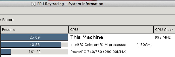

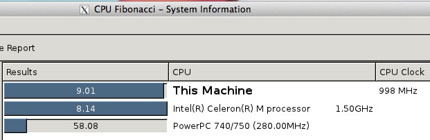

I set up a Linux virtual machine as a test, and it actually performs pretty well. Here's some CPU benchmarks for the VM. Keep in mind these numbers are for a VM with only one CPU core enabled as single VM performance does not improve with more cores. Native Linux running directly on a Fit-PC3 will be faster.
