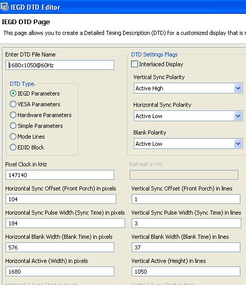

In IEGD I manage to create a new DTD (see screen copy attached).

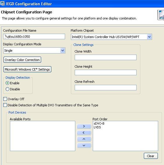

Parameters for the 1st page of IEGD configuration editor : single display, enable display detection, port order : sDVO and then LVDS (see screen copy).

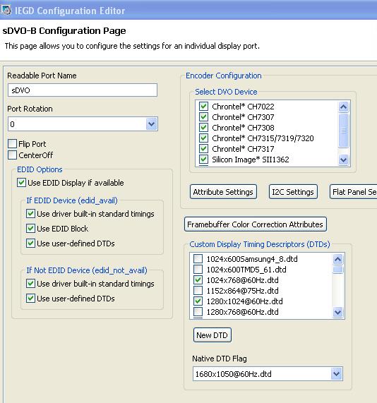

Parameters for 2nd page of IEGD configuration editor : all check boxes ticked for EDID option but I don't know what to parameter for DVO devices, attribute settings so I ticked every choice ...
I didn't filled any option in the attributes pages ... perhaps it is an error ??
XP driver for 1680x1050 display / IEGD Driver
- sDVO configuartion Page : no attributes settings set

- New DTD for Display 1680x1050
- NewDTD.jpg (56.41 KiB) Viewed 45007 times

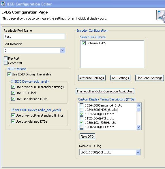

Last screen copy for LVDS configuration (no attributes settings have been parametered).

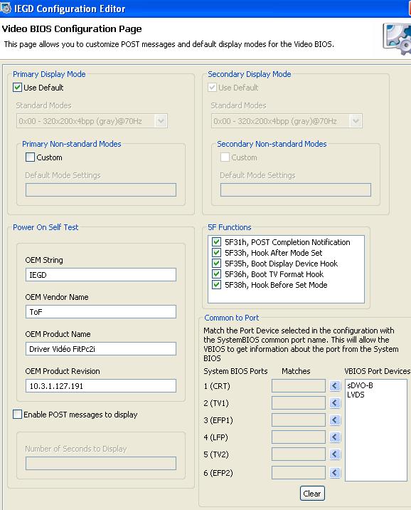

Page 4 and 5 of configuration set up attached ...
- New configuration page 5 and last
- NewConfp5.jpg (75.45 KiB) Viewed 45002 times
- New configuration Page 4
- NewConfp4.jpg (29.44 KiB) Viewed 45002 times

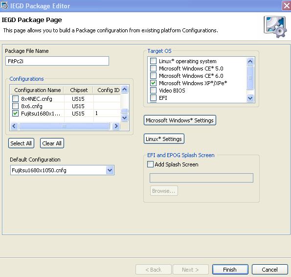

I have then produced a new package with my configuration and target OS : XP/XPe.
Result is not working : black screen at windows opening : no signal detected by my display.
FitPc2i works pretty well and the only issue regards this display driver problem.
Hope you can help.
Best regards.
MyConf : Fit Pc2i (Nr-100521-051) - WinXP Pro SP3 - display Fujitsu Scaleoview H22w-1
Hope you can help.
Best regards.
- NewPackage.jpg (51.63 KiB) Viewed 44996 times

IEGD driver generator is beyond the scope of our support. I will try to provide a few tips - but I am not an expert on that. For more details consult IEGD documentation.
fit-PC2 is using only the SDVO interface with a Chrontel CH7307 DVI transmitter. LVDS interface is not used. Settings in IEGD should be chosen accordingly.
Attached please find reference IEGD configuration file for fit-PC2 you can start with. First generate a driver and see it is working, then modify configuration as per your needs.
