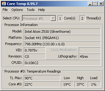

Solution for my Fitcp2I to pick a cooler on it all that you need is: 1x Tube heat sink compound 10ml, Cleaning alcohol 3ml,
1X heat sink compound glue -> http://www.reichelt.de/?ARTICLE=38063;PROVID=2028 , 1x Cooler some like that -> http://www.reichelt.de/?ACTION=3;GROUP= ... ee0f7b54c5 or -> http://www.reichelt.de/?ACTION=3;GROUP= ... ee0f7b54c5
Work: Well you have to clean all surface with alcohol then take the cooler and put the heat sink compound on the survace but let on each korner aprox 1cm x 1cm free of heat sink compound that space is for the " two component heat sink glue" to fix the cooler on the fit pc.
Result: I made a 5 hour cpu test the max temp -> 37°C
Idle Temp -> 28-29°C
Room Temp -> 22°C
Design: Well .... you must like it, but it works.. :)
