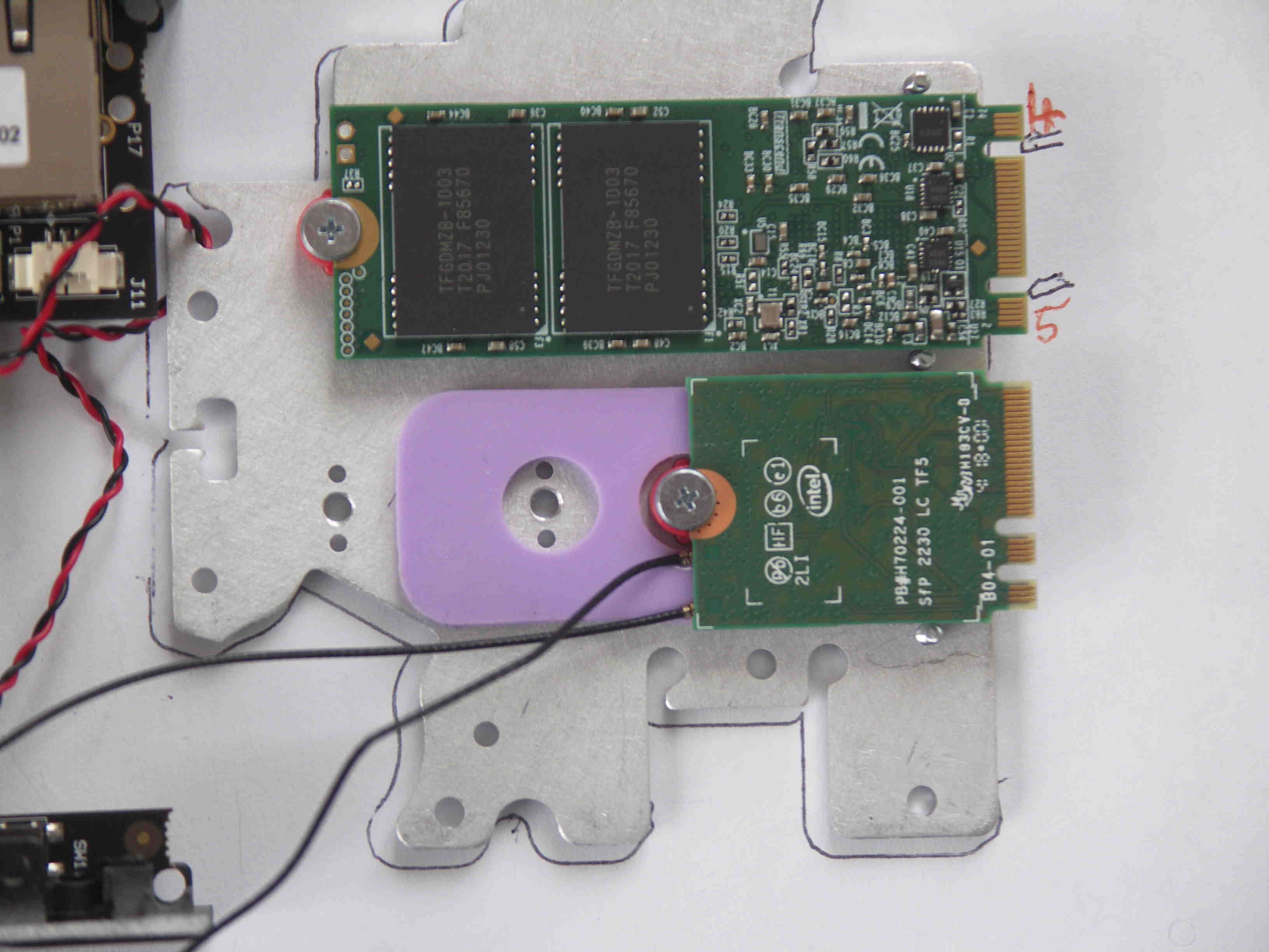

I have a MintBox Mini 2, FITLET2 CJ3455 which uses Transcend 64GB ssd -- and it works fine.
I purchased Transcend 128GB M.2 SATA 3 type 2260 as this ssd has the same 60mm length as the existing 64GB.
My procedure for the exchange went to plan, exactly as explained in the Fitlet 2 Owners Manual - see attached photos. Pict 017a is with the new 128GB installed.
The appearance is identical because the two drives are exactly alike.
Sadly the Transcend 128GB is not recognised in BIOS.
Swapping back to the original 64GB, then all is normal with BIOS recognition.
I hesitate before returning the Transcend 128GB back to Amazon.co.uk to get a refund - since there might be factors I am not aware of.

Here you can find a list of checked SSD drives. In your case it can be known M.2 SATA issue
