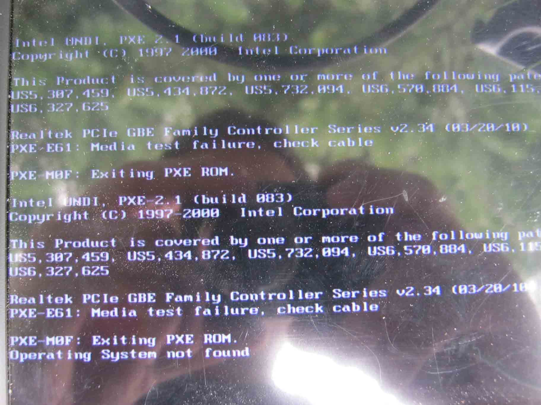

We recently bought a batch of 8 FitPC2i with windows 7 (PN:D2G-C1600-W). After a while some units seems to crash and display a error when trying to reboot itself.
"PXE-E61: Media test failure. check cable
PXE-M0F: Exiting PXE ROM
Operating System not found"
(see attached file)
When we manually reboot the PC with the power button the PC seems ok.
Our application has to run for several days and so far some fit-PCs crashed after 1 or 2 days.
I did not touch the bios setup.
What could cause the error??
Please help!
Operating system not found
- Operating system not found
- Error_FitPC2.jpg (118.73 KiB) Viewed 25231 times

What you see, is the PXE boot feature. If you have no need in the PXE boot support, you can disable it from the BIOS menu. Please try to disable that feature, and soft reboot the system several times to see if the problem persist.

I will try the disable the PXE boot and see what happens. But why does the PC is not booting from the internal drive anyway? All our FitPC use a SSD storage.
The fitPC are placed in a sealed case for outdoor measurements. So, I suppose that the heat can build up. However, I'm not sure yet if it is related to the crash. Indeed, we have already used the same configuration in plain sun on a hot day without noticing any problem. The recent crash cases were not in extremed weather condition.The sealed case may be the source of the problem. What temperature the FitPC can tolerate?
Is it possible that the SSD fails as the temperature climb?
Re: Operating system not found
The most logic reason for this issue is the storage device failure. Once FitPC2 is unable to find an OS on a preferred device in the boot order, it skips to the next one. The most common reason of the OS absence is a drive failure.
The guaranteed FitPC2's operation temperature range is 0~70C with a SSD drive as a storage

It seems there is a compatibility issue between fit-PC2i and this SSD.
If you wish to send to CompuLab an SSD for testing we may be able to tell more, but given the time pressure it may be more effective to choose another SSD.
