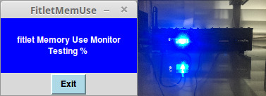

App Initialization : Maximum Brightness

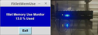

Low Memory Usage: Dim fit-statUSB

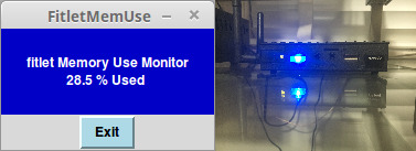

Medium Memory Usage: Moderately Bright fit-statUSB
