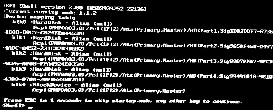

I'm having a weird problem.
I formatted my Intense PC and installed Windows 8, but I probably messed something up because it wont boot up.
After I turn on the pc I get this message:
(sorry for the quality, I had to lower it to upload it here)
What I've been doing since this problem is booting with a startup disk via usb CDROM and works fine.
Any ideas?
Ron
Re: Can't start up Windows
Hello Ron
I guess you should reinstall your Windows 8 copy, because the system is unable to detect a bootable harddrive

Hi Gabriel,
I reinstalled, repaired it, but nothing.
I'm sure I did something wrong, maybe in the bios? did I remove something?
Have you tried to install other operating system like Windows 7 or Ubuntu?
Have you tried to get back to the BIOS default settings?

Someone told me it might be related to something called "fixmbr" but I have no idea about that.
This is related to MBR of your harddrive. Try to repartition it, and reinstall the system. You can also try another HDD for your system.

I repartitioned it know with no reinstalling but nothing happened. I'll try the reinstallation after backing up some important files.
Do you know how can I update my bios?
Because I entered Phoenix BIOS UPDATE webpage and they make me download some third party software which costs extra money. From esupport.com.
Shouldn't it be for free?
I'm sure it will fix everything up.
Please don't download and apply other BIOS images other then from a Compulab website. An unofficial BIOS image may brick your device and void your warranty. We will release in a near future IntensePC BIOS update. It will include several fixes and features.
