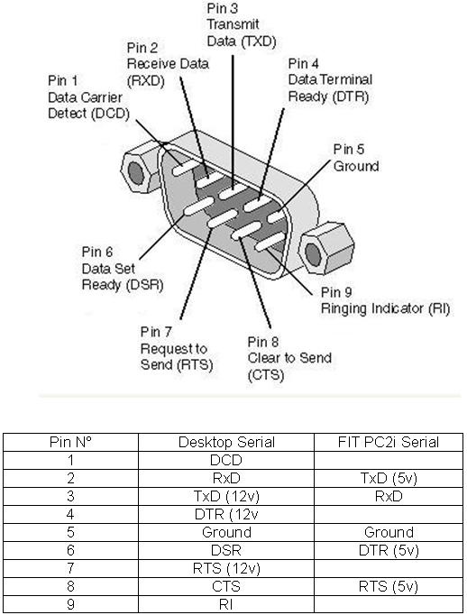

I wanted to connect a device on my serial port on FitPC2i and noticed that pins were not connected as usual.
Also serial port delivers -5v/+5v instead of +12v/-12v.
It's not a major issue and my device works properly but I had to change wire connections on my device.
I just wanted to know if I missed something or if there was something to be corrected ?
See attached for details on pins connection on my FitPc2i.
Best regards.
ToF
Re: Serial Port information
Please note that cable is RS232 female, so it actually behaves like a device - not a PC. That's why the TX/RX and control signals are crossed.
A gender-changer will fix that.
