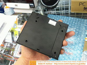

I am installing a Rev 1.4 fitpc2 in a large metal cabinet with an open back. I plan on attaching the fitpc to the side of the cabinet to both keep the install need looking and take advantage of the large heat-sink capability of such a structure. Are there mounting holes for such an install? Will I need to fabricate a bracket?
I wish there were more than just a front shot and a drawing of the back available on the web site.

There are 3 small holes on the bottom of Fit-PC2 case. They are made to support VESA mounting bracket sold for Fit-PC2. You can use them.
Re: Mounting to metal cabinet
You would want to couple the top side of fit-PC to the side wall of the cabinet for best thermal conduction. I suggest a U shape bracket hugging the fit-PC, or a metal band.

irads wrote:You would want to couple the top side of fit-PC to the side wall of the cabinet for best thermal conduction. I suggest a U shape bracket hugging the fit-PC, or a metal band.
That's kind of what I was thinking too. Thank you for confirming.
This install is to run a school bell system. So it will not be running much more than an cron job and SQLlite most of the time. There will also be a web interface for setting bell times. I don't really expect that much heat build up. However it will be running 24-7. I plan on using an intell SSD so there will be no moving parts. Current plan is to use CentOS.
