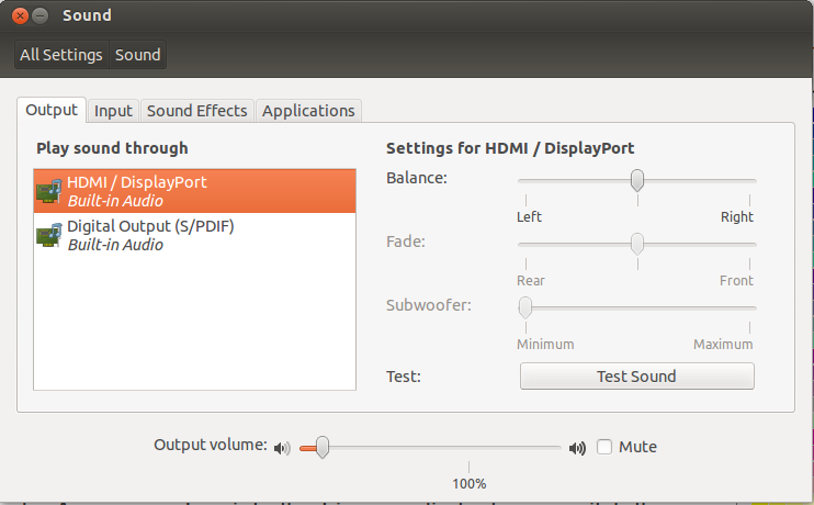

Update:
I discovered, after another audio dropout caused by using the Linux built-in audio test app, that what is actually happening is that the audio spdif jack is switching to digital mode. Who knew?
I switched my video hookup cable from a DVI/HDMI adapter to a straight HDMI cable to my monitor, and plugged in my audio amp to the 1/8 stereo plug provided on the back of the monitor.
Now, after boot, the audio is not working...actually, its in analog mode. As soon as I go into the Linux audio test app, then switch the default output audio to HDMI, it all works quite well.
I plan on buying a small spdif/analog converter so that I can provide a better way to decode the digital audio.
I'm thinking these audio issues are another driver issue with Linux and the intensepc sound 'card'...but for now, its a good workaround.
- Screenshot36.png (45.5 KiB) Viewed 8590 times

The 3.5mm audio port on the IPC can be used for analog or digital (SPDIF) coaxial audio output (and maybe input but I haven't tried that). I use pavucontrol, the pulse audio GUI tool, to select which output (analog/digital/HDMI) I want to use as the main output.
