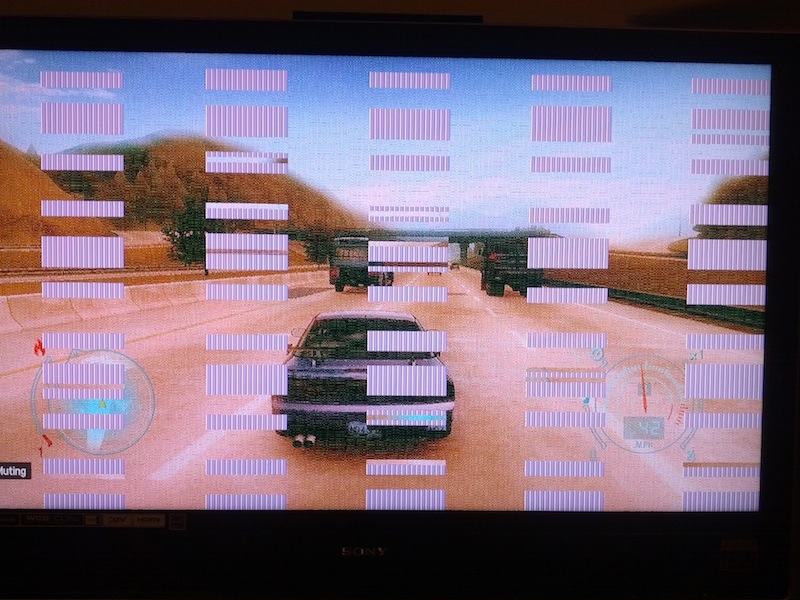

Ok, maybe XBMC doesn't like Intense PC on Ubuntu & Windows 7. In order to check my theory, I installed a few old games (Need for Speed Undercover, Vegas Rainbow, Flight Simulator X etc.) and tried to play them for a few minutes under Windows 7. Boom, in 5 minutes the computer freezes again. :cry:
So I've witnessed exactly the same problem on Ubuntu & Windows. Hard to believe it's a drivers issue, since both OS use different drivers. Is it a hardware problem?

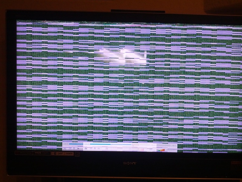

- More disturbing news...I downloaded latest version of VLC player and played a 1080p Movie. The movie played for 25 minutes before the PC froze again. I am attaching the screen shots of how the screen looks right after PC hangs.
I can't think of anything else but to conclude that any GPU intensive program (3D games, 1080p movies etc.) cause the thermal issues on IntensePC, hence causing it to hang.
I wonder if other people are also experiencing similar issues while playing 1080p (1920x01080 progressive resolution) movies or 3D games.
A reminder that I conducted these tests on Windows 7 with latest updates and IntensePC drivers. I have a 100GB SSD (OCZ Brand) drive with 16GB (Corsair Dual Channel DDR3 SODIMM) memory.

IntensePC hangs 5 mins after I started Need for Speed Undercover released in 2009.
Screen goes bad right when IntensePC hangs while playing movie.
Re: Intense PC hangs with Graphics intensive applications
Thank you for providing detailed info. We haven't encounter such issue before. Our R&D team will investigate this issue, and I will update you with the results
