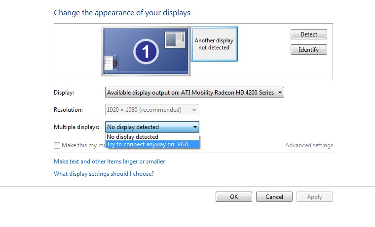

I've just tried the method on an unrelated desktop PC with AMD/ATI chipsets and it still works, so i'm not sure what the problem is on your machine. Attached is a screenshot of the resolution screen with what the setting looks like on this unrelated PC. Maybe post a screenshot so I can try to help?

Thanks for the screen shot. It is the same screen that I get using several much older laptops, but with the Intense PC, it never changes. On the Intense PC, it seems that the Detect button does not trigger anything because it never turns grey or the like.
