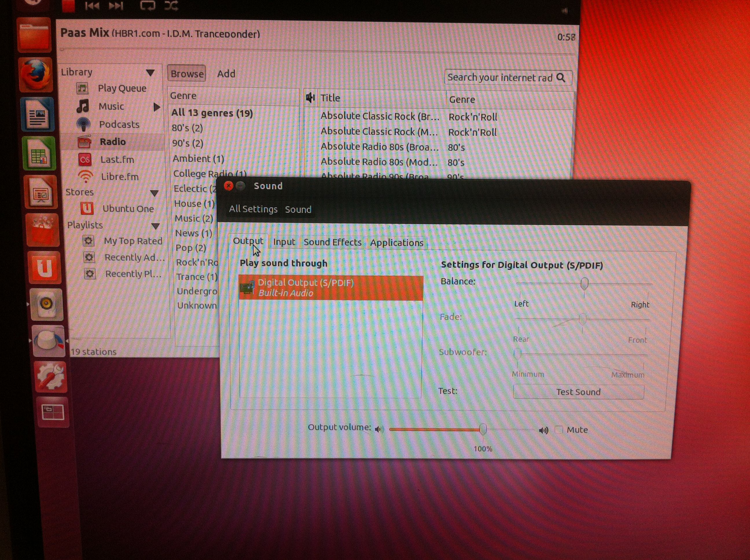

Tested on two Intense PC entry models, to rule out hardware problems. I started by installing Ubuntu 12.04, ran system update (to 12.04.1).
There is just one audio output, "Digital Output (S/PDIF) Built-in Audio" (photo attached).
Audio doesn't work. If I pull the audio connector out and hold it at just the right spot, I can hear sound that's quiet and it's very distorted. Oddly, if I turn the volume down (while holding the connector at just the right spot), the audio gets less distorted but is still really quiet.
If I plug in a USB audio speaker, audio works perfectly fine.

I tried a bunch of other Pulseaudio and other suggestions I found online...nothing seems to work. It looks like the analog interface is just not found by the system. Everything else appears to function. Any ideas?

I needed to first install the PulseAudio Volume Control application from Ubuntu's Software Center. Launched the application, went to the Configuration tab and selected "Analog Stereo Duplex". Audio now works!
However, when I go to system settings, the audio reverts to digital output and stops working with headphones. I need to go back into Volume Control and reset to Analog to get audio back. Weird.
Sounds like an Ubuntu so PulseAudio bug (or both!).
