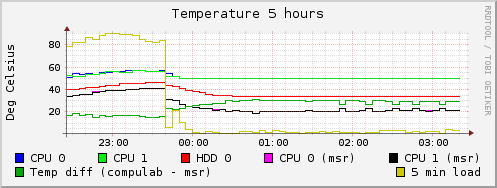

I will crank up both cpus to try and raise the cpu temp above 50, then I can compare both outputs. But I will probably have to wrap it in something as my heatsinks are very effective in keeping the cpu's below 50 ;) (and the heating at home is off, so low ambient temperature). Follow it here: http://home.panman.eu/stats/
Edit: Nope, too cold there. Will try again tonight with the fit-pc wrapped up.

Ok, it is now wrapped up and warming up nicely. You should be able to see the cpu temp measured from the first script increase soon and hopefully it is a fixed offset, so it will just be a matter of changing the tj_max.
edit: I've added a line for the difference (dark green), it seems to hover around 15 degrees as soon as the compulab script goes above 50. Maybe the TJ_max in this case is 105?
Edit2: Ok I think that is warm enough :) I've unwrapped it, back to normal. Perhaps this empirical data will help. Very interesting observation is that the MSR values drop much quicker than the compulab script, so I expect them to be different sensors.
Screenshot showing about 15 degrees warmer reading from compulab script vs. msr script. (for compulab temps > 50)

Well, whatever it is, it seems to work ok when I add 15 to the msr value, which I did. Looks a lot nicer on my plots, and I don't have to worry anyway with these cool temperatures. Scientific, huh? :-)
