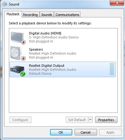

When I insert the headphones into the right fit-pc3 audio input there is first some soft white noise in both channels, then a little louder still in both channels, then a little softer again only in the left channel.
Attached to this post is a screenshot of my pc audio device control panel playing Spotify with no sound.
Re: No sound in Windows 7 Pro
As I see from the picture, you have no analog output device attached to the FitPC3. When you attach the speakers to the audio out, do you see any popups from the system tray?
