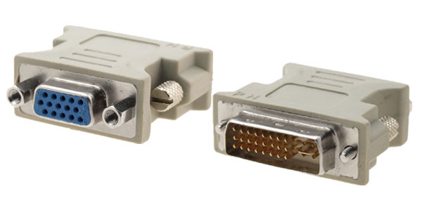

fit-PC 3 comes with an HDMI to DVI adaptor, so is it not possible to just extend the supplied adaptor with a DVI to VGA adaptor such as the one shown in the attatched image?
HDMI --> DVI --> VGA
DVI to VGA.jpg (20.93 KiB) Viewed 22219 times
Re: VGA (or lack thereof)
From this picture I can't tell if will suite or not. The adapter should convert a digital (HDMI/DVI) to an analog (VGA) signal. If this is only a mechanical adapter, then it will not work.
