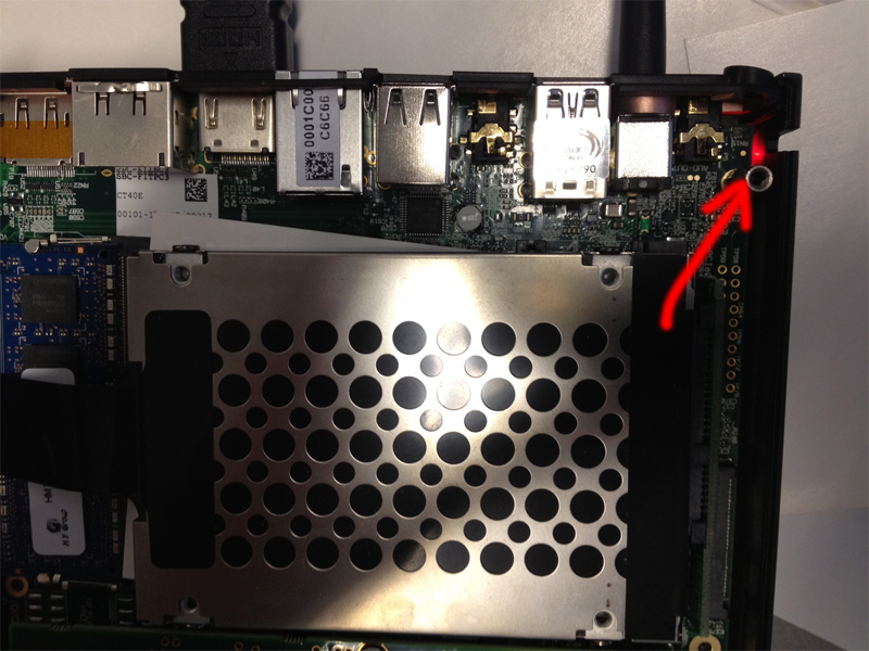

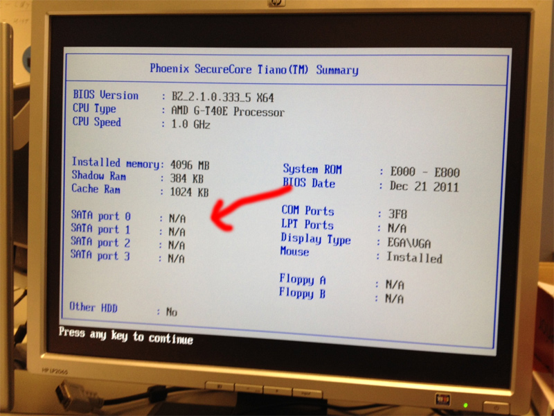

My FIT-PC3 doesn't seem to recougnize any of the harddisks I've tried.
After closer inspection I do see a red LED on the inside of the case, but I have no idea what this means.
The drives I've tried using are:
- 160GB Intel SATA SSD
- 1TB Western Digital WD10TPVT SATA
I've carefully inspected that the vertical SATA-connector-board is correctly plugged in to both the harddisks as well as the connector on the FITPC motherboard itself.
Is the FITPC3 defective or am I doing something wrong here?

I did test them. The SSD 160GB drive is actually the drive out of the laptop from work.
I'm sure both drives are working correctly, buth the FitPC doesn't seem to recougnize either of them. I've tried if I could feel if the 1TB drive would spin up (simply if there's power delivered to the drive) but I couldn't sense it at all.
Re: No HDD detected
I suggest you to RMA the unit. I am sorry for an inconvenience
