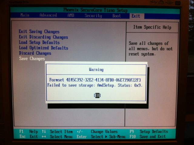

Hello,
my fit-PC3 Pro's BIOS sometimes fails to save changed settings. It always reports status 0x9 and if it fails, no changes are possible at all.
I'm not sure what circumstances cause it to work again -- the first time this happened, changes became possible again in the morning after I left the fit-PC3 disconnected from the power during the night, and now it's entered a phase where no changes can be made the second time.
Regards,
Resonator

Can you explain more precisely about status 0x09? Where do you see it?
Did you notice any strange behavior of the date or time in the system?

This status code appears in a dialog box that informs me that the changes could not be saved. There also is a longer message and a longer code. I've attached a picture of the message that appeared when I attempted to set the option "AC Loss Control Setting" to "Stay off" (just to get an example to take a picture of).
The system clock is running as expected, I also didn't have any trouble setting the time.

Hi.
It looks like the hardware problem.
Please contact our RMA department:
http://www.fit-pc.com/web/sale-terms/#RMA
We apologize for the inconvenience.
