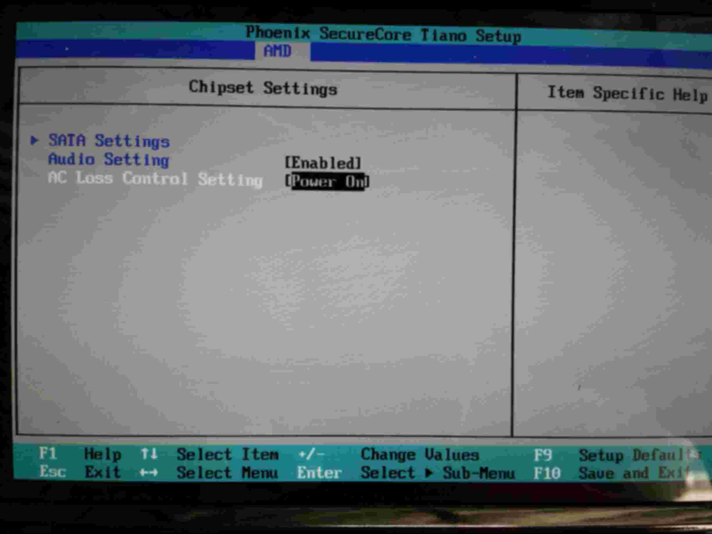

We have a couple of Fit-PC3 with the BIOS configured to Power On upon AC loss and it works sometimes and sometimes not. The 12 VDC supply looks clean - doesn't sag.
- Photo of BIOS config for Power On
- IMG_20131107_133337.849.jpg (88.05 KiB) Viewed 18732 times
