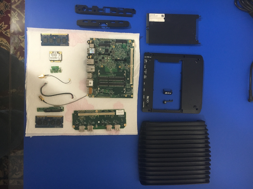

Cleaning and Restoration
The restoration process is fairly straightforward as follows
- Completely disassemble the unit
- Clean the case components using hot soapy water
- Rinse the case in distilled water
- Dry the case thoroughly using gentle heat.
- Clean and flush the circuit boards using distilled water.
- Final flush the boards using isopropyl alcohol
- Dry the boards using gentle heat.
- Spray all connectors and contacts with de-oxidizing /protectant solution
- Reassemble all components

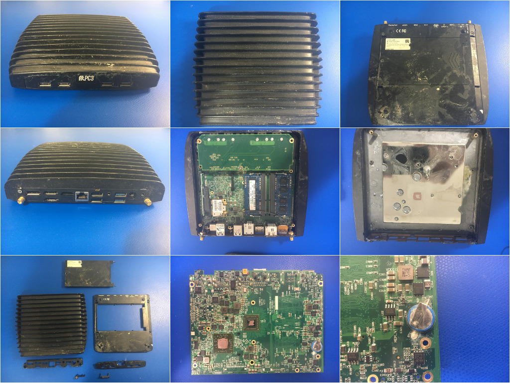

Before Cleaning

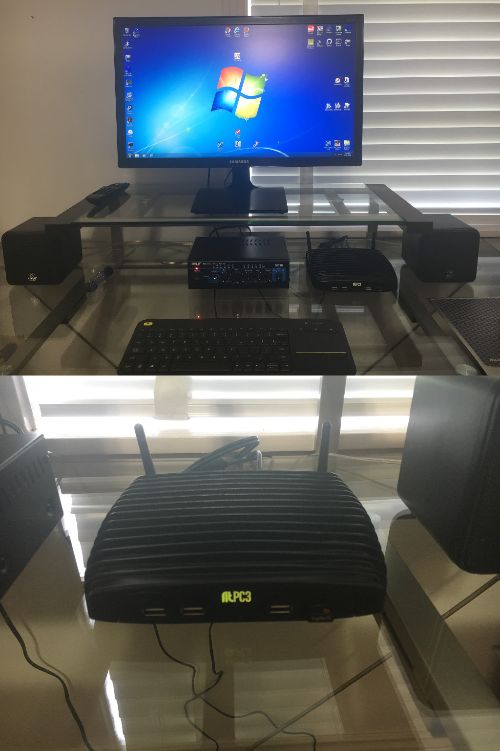

Back in Operation
fit-PC3 Pro is the 3rd Compulab computer I have successfully restored following the flood. At 1st I thought there would be no hope for these units, but I have been pleasantly surprised by their renewed operation. None of my other electronic equipment was savable after the flood, and the Compulab equipment has been the exception. I have to believe that such computers which can be brought back to life after being subjected to prolonged immersion in flood waters and 2 years of neglect, will perform quite satisfactorily in the harshest industrial environment.
