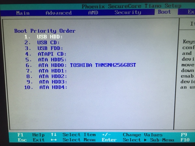

Here is what I have experienced through the years.
1 Will replacing the bios make it unnecessary to recover the password first?
Re-flashing the bios PROM should in theory reset the password. If it doesn't, you still have the option of clearing the bios using the jumper method.
2 Are there any guides as to how the bios should be set and where can I find them?
Both resetting and re-flashing the bios should return everything to factory default settings. These techniques are used when the bios gets corrupted in order to restore proper system operation. However, if you have a problem, I will send you the settings used in my fitPC3.
3 Am I right in deducing that the machine will carry out the bios replacement from a cold start? ( That is, BIOS replacement stick in place, press the go button, and it will fire up into dos. Then select the new bios. Eureka!)
If your existing BIOS boot order priority is set so that "USB HDD" is at the top of the list, then your system should boot into DOS from the USB drive and allow you to re-flash the bios. However, I had to re-order my fitPC3's boot priority list in order to gain the ability to boot from a USB thumb drive. If your boot priority does not allow you to boot from a thumb drive, then you will have no choice but to reset the existing BIOS in order to eliminate the unknown password. You can then gain access to the BIOS so that you can adjust the boot order.
Best regards and good luck,
