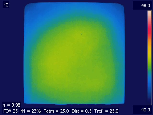

I want to get the LP version for my Domotica (HomeSeer), but I've read things about the fit-PC2 getting warm/hot without the optional external heat-sink
fit-PC3 Thermal design is better than fit-PC2. In particular the LP version runs much cooler. For example - see a thermal image of fit-PC3 Basic playing HD movie at 12W (25C ambient).
I expect HomeSeer on fit-PC3-LP to consume even less.
