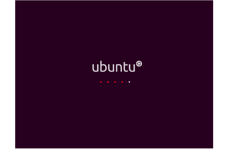

I've tried to install from a iso burned on cd downloaded from Ubuntu official site; I've tried Ubuntu 11.04 Desktop/Server and 11.10 Desktop/Server.gabrielh wrote:Hello
Can you please give some more details of the installation process? I.E. OS, install media, the hang up screen?
The installation hang on the screen attached.

Hello
If you press an "esc" key while you see this screen, is it disappears? Can you post me the installation log prior it hangs up?

Re: Can't install
When you press the esc button, and the ubuntu screen is disappears, you should see the log
