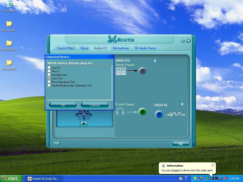

When you insert audio jack, does the audio manager appear automatically? Do you get any "balloon message" in the system tray?
Please, see the attached screenshot for reference.

Re: No analog audio
Nope, and it is set in the settings to do so. I had intalled Win7 before and had the same issue but it was to slow to use for what I wanted to I didnt bother to troubleshoot.
