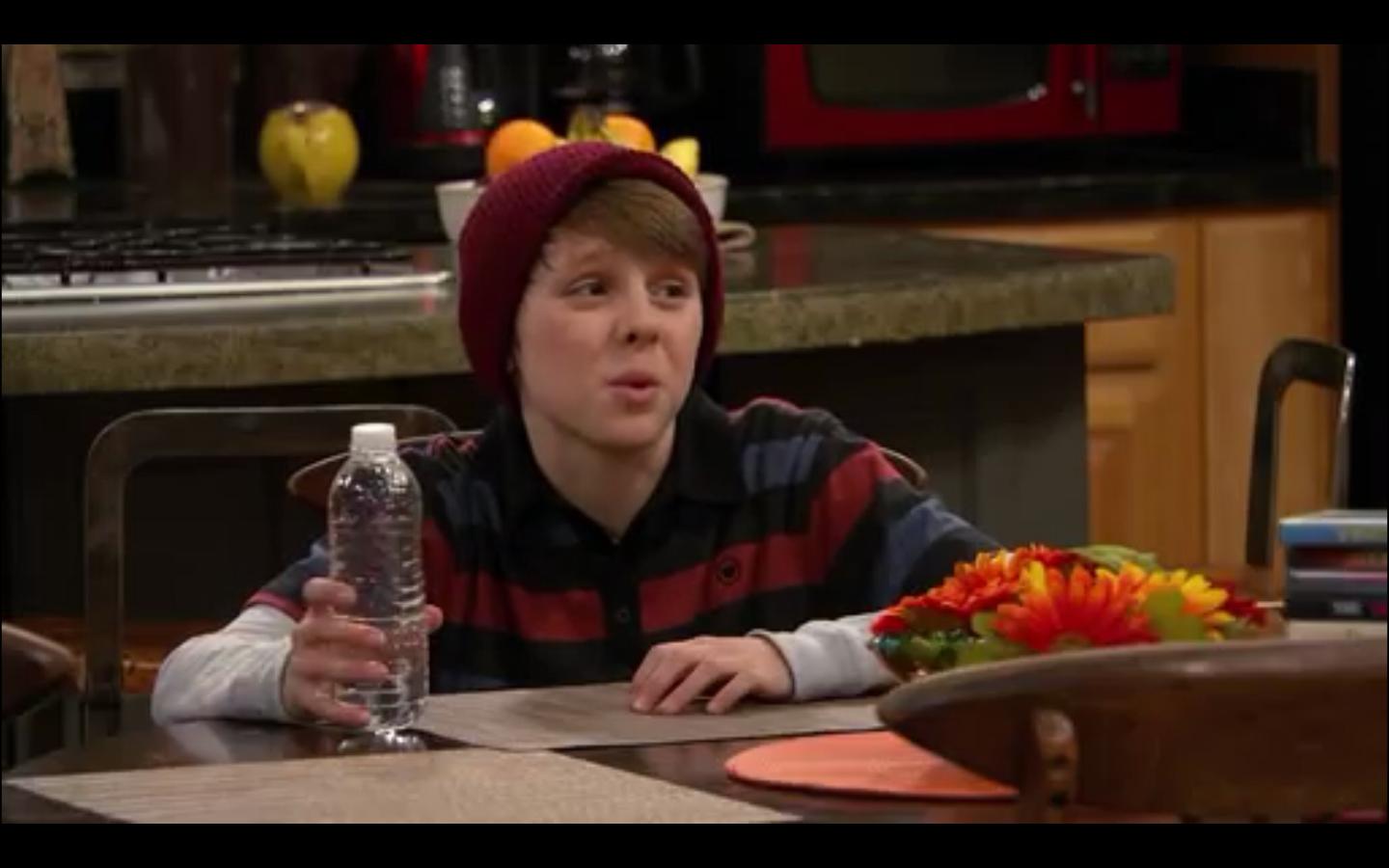

OK, glad everyone tried out all these sound strategies: I finally managed to discover that basic sound quality is what determines success in XP. I did this by using a USB sound device, which is still my first candidate for minimum loading of the cpu. The secondary candidate is the xp sound driver from the fit-pc2 downloads, set to the same sound quality as the USB sound device (low, CD-quality), which is almost as fast. From testing in Windows 7 and Windows 8, I prefer the gma500 driver set to 1440x900, lower than the "recommended" setting.
Taken together, that lets you play full-screen, full motion streaming Silverlight video from the North American distributor and from other Silverlight sources. This is an experimental installation that does not install streaming flash so as to force Silverlight and uses the secondary browser as the designated primary browser.
Enclosed is a full-screen capture jpeg.
