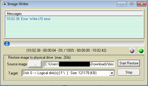

One little problem I discovered is that you can not create the bootable USB stick while running Windows 7.
After downloading unzipping the zip file, I run ImUpdate.exe.
I get an error when trying to create the bootable USB stick.
See attached file for error.
I had to go back to a Windows XP machine to create the bootable USB stick.
