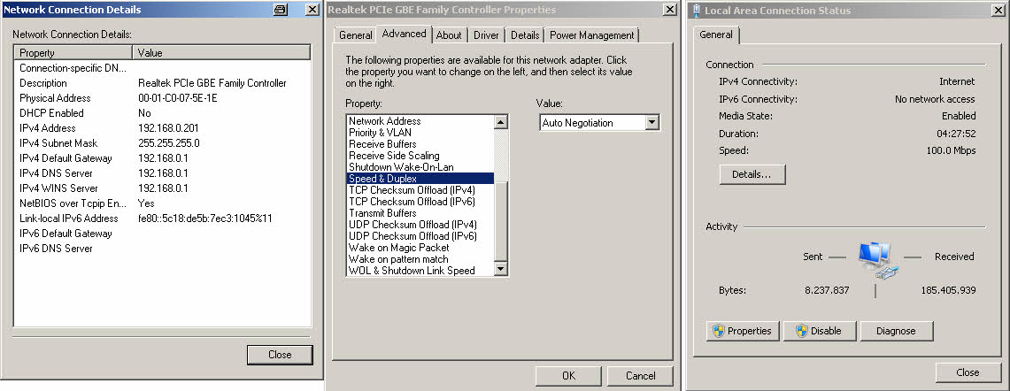

i cant get 1gbit connection but my hardware support it switch (8 port gigabit) fitpc2I (Gigabit) LAN-wire cat.6 what is wrong? any solution?

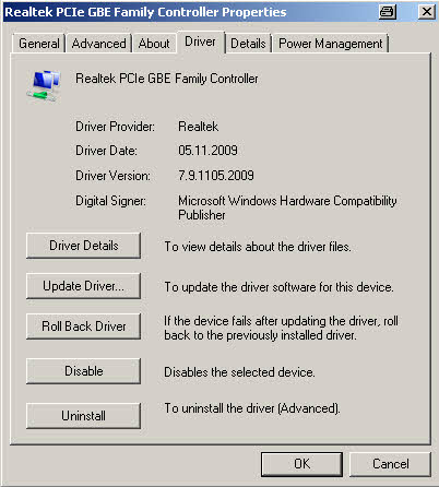

Re: No 1Gbps Ethernet
My OS id windows7 pro my switch is a Netgear GS108 ->Link http://www.netgear.de/Unternehmen/Switc ... index.html
my older PC does support 1GBIT on that port so it can't be a wiring mistake.
What is the actual rate you are seeing? What you mean? my transfer rate from one pc to an other is about 5,6MB/sek thats poor...
Hi.
The speeds you encounter were probably more a factor of the hard drives being used than the network connection.
