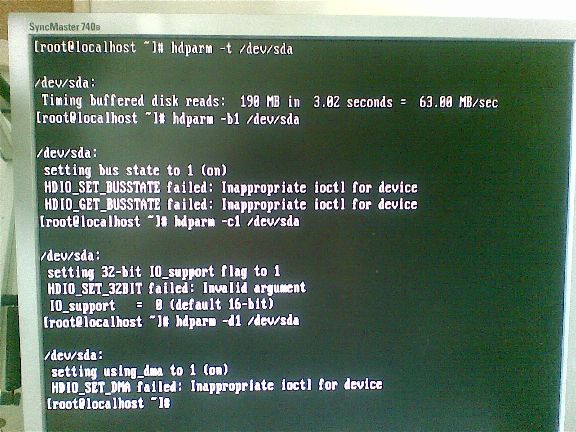

After reboot, execute "hdparm -t /dev/sda" to verify that the patch is applied correctly.
You should get speeds of about 50-60 MB/sec

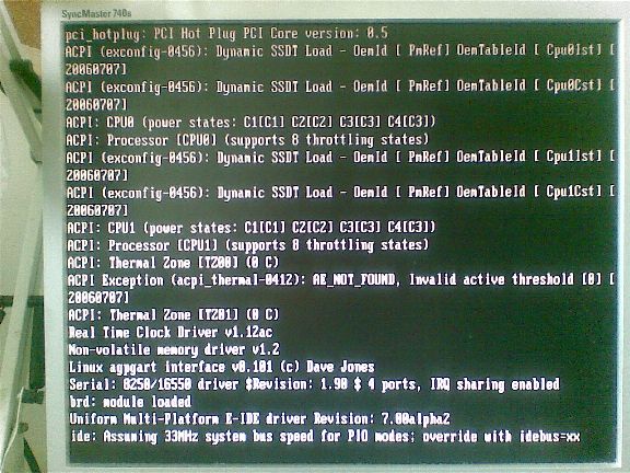

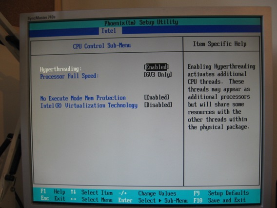

Problem #1: Sometimes the computer is stuck at boot time. After the line "ide: Assuming 33MHz system bus speed for PIO modes...", the computer stops any activity and keyboard stops responding.
Solution: Make sure to disable CPU C-States in BIOS
(Go to CPU Control Sub-Menu and set "Processor Full Speed" to "GV3 Only").
Problem #2: When "hdparm" command is executed with certain parameters (i.e., "d1", "b1"), it returns "Inappropriate ioctl for device" error.
Solution: This is expected behavior. "hdparm" command only fully supports PATA (IDE) drives. Since you have SATA drive, only certain "hdparm" options will work. See: http://lists.centos.org/pipermail/cento ... 09763.html
