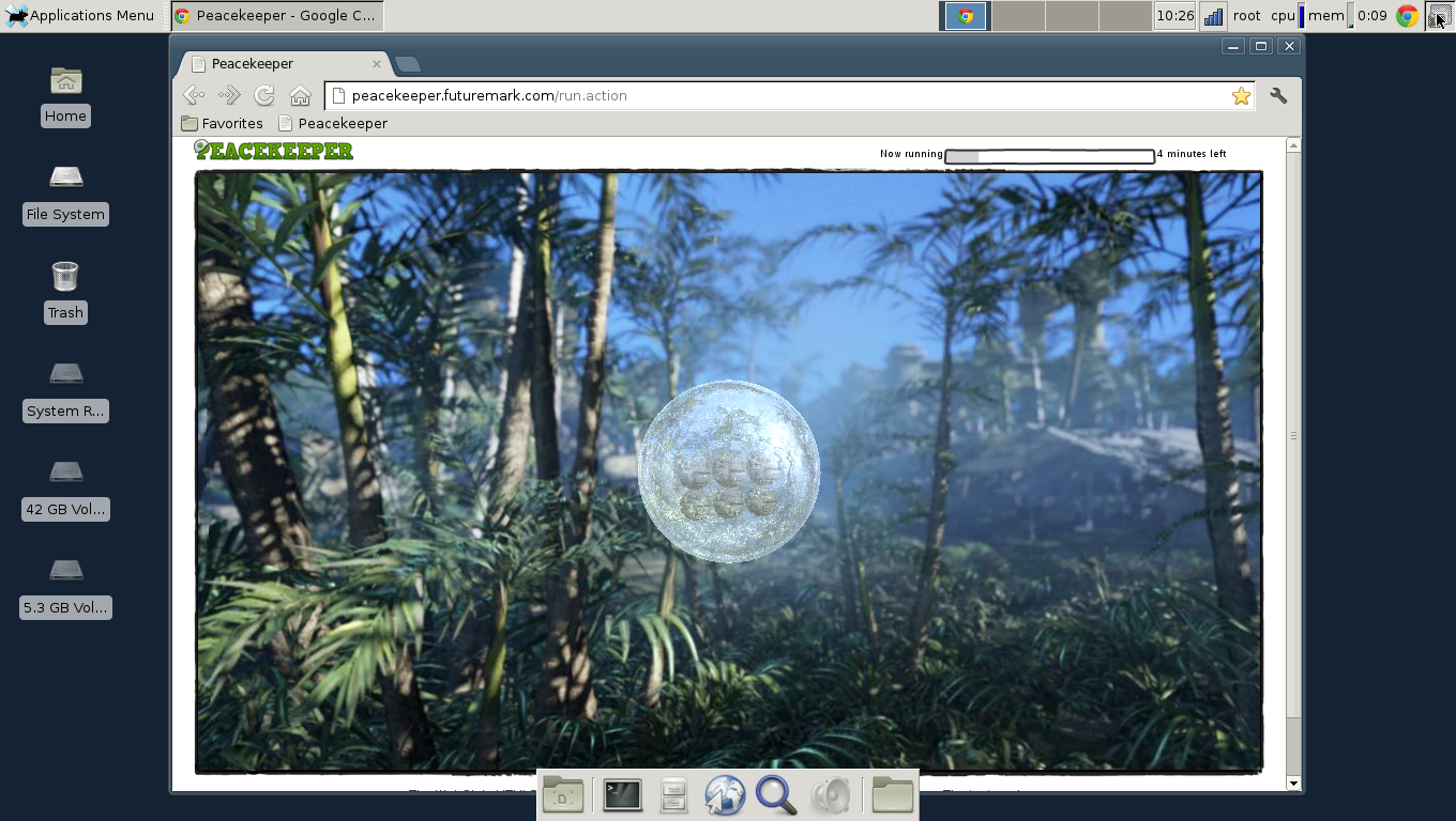

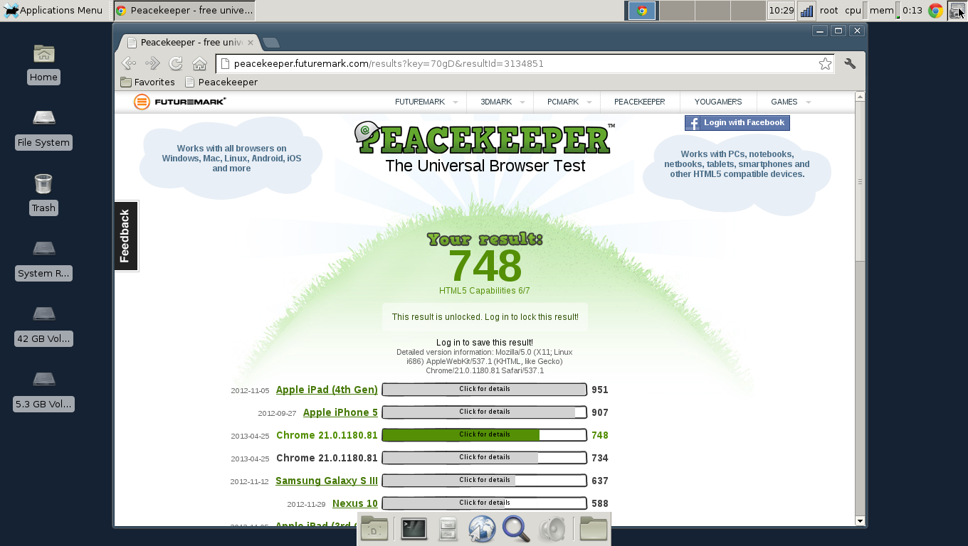

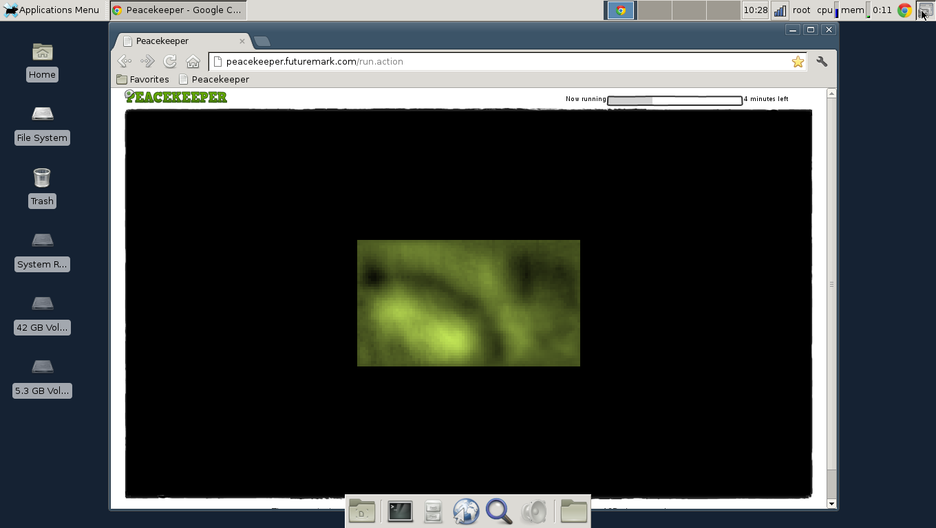

If you install Slackware 14 on the z550, or even the z530, using the AbsoluteLinux 3.7.1 kernel and the fbdev_drv.so from the /extra directory, you get an implementation of xfce4 as the desktop. If you then install google-chrome so that the peacekeeper browser benchmark can be run, you get something with a fairly high benchmark score, comparable to the DN2800 Cedar Trail. Please notice the "mem" memory meter on the upper taskbar. Very low memory usage makes this a candidate for the z530.
- peacek3.png (250.57 KiB) Viewed 19181 times
- peacek2.png (84.03 KiB) Viewed 19181 times
- peadek1.png (906.5 KiB) Viewed 19181 times

Actually, I downloaded the latest 3.9.5 kernel and compiled it using a Slackware config with CONFIG_MATOM=y so as to find out whether anything has improved vis a vis the fit-pc2 z550. Running the Peacekeeper benchmark gives a latest value of 757, but things like streaming video seem somewhat smoother, and there is all kinds of 3d acceleration with bulging widgets evident all over the screen.
