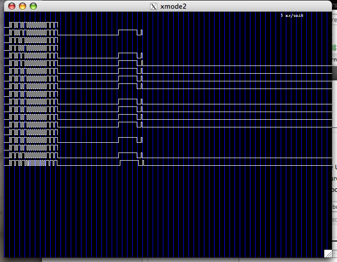

Has anyone gotten an apple remote (A1156) to work with fit-PC2? The strange thing is that I can fit-PC2 to pick up the buttons with irrecord but it fails to show any buttons being pushed when using irw. Any idea? If you got it to work can you post your lircd.conf? I've tried several different ones posted on numerous websites.

Try to run and press buttons on your remote. You should see waveforms of IR signals. Ensure that you have same waveform while pressing on same button, that signals for all buttons have same length, may be you will see something unusual. If you do not have xmode2 - it`s in lirc-x package.
Code: Select all
sudo xmode2 -d /dev/lirc0

Hi Denis,
First off, thanks for you help. I can see the frequency but I don't understand how this helps me with lircd. The frequencies seem to be the same. The only thing that differs is how long I hold down the button for. Holding it longer shows a longer frequency obviously. I've attached an image displaying this.
Does this mean the remote will not work with irw? My goal is to get the remote to work with XBMC.

Xmode picture is fine, it means that your remote is sending appropriate signals, kernel driver is capable to decode them. Here are things that can be verified:
1. While recording with irrecord do you receive "Signal length is 39" messages in dialog? If not - start irrecord again. You should press remote buttons about 1 sec, not release them immediately.
2. Check if /etc/lirc/your_remote_name.conf was created properly and contains button`s names and their raw_codes.
3. Don`t forget to copy your_remote_name.conf to /etc/lircd.conf before testing with irw
Code: Select all
sudo cp /etc/lirc/your_remote_name.conf /etc/lircd.conf
sudo /etc/init.d/lirc restart
irw
Compulab's Linux support

I have tried several remotes, even some buttons of air conditioner controller give good signal (like in picture you have sent).
Let`s debug step by step.
1. Do you receive "Signal length is 39" messages in irrecord dialog?
2. /etc/lirc/your_remote_name.conf contains button`s names and their raw_codes?
3. /etc/lircd.conf and /etc/lirc/your_remote_name.conf are the same files?
