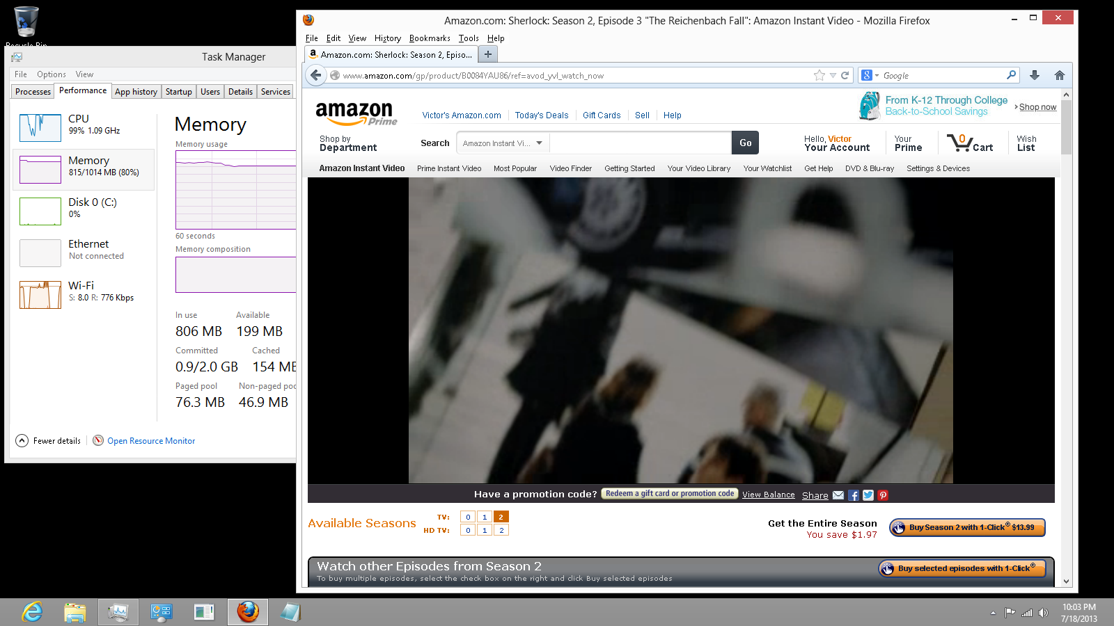

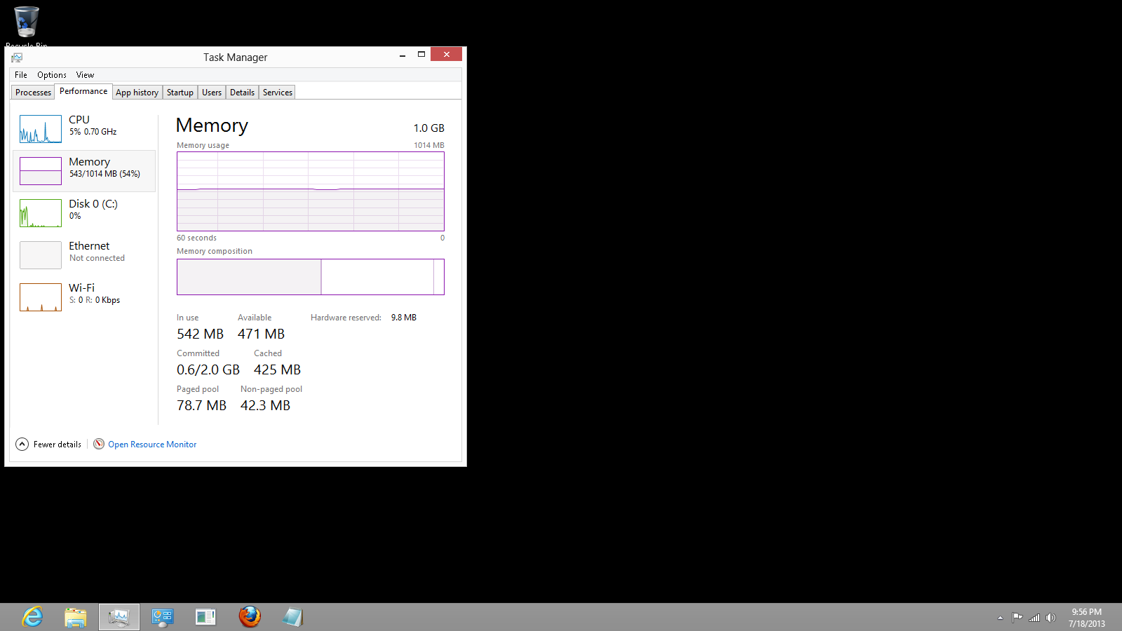

I did some testing in RIPLinuX to determine a "good" resolution for the z510, and I discovered that the gma500_gfx module wasn't able to handle 1900, and 1366 caused streaming flash problems. So, I settled on 1600x900, which actually gives rather good results. On the possibility that Windows 8 has the same "problem" with the iemgd driver, I set the resolution at 1600x900 and found the task manager showing relatively low cpu utilization and memory use. The following two png screen captures show what happens. Note that the Linux screen captures have much higher resolution and even show the rounding of edges.
- screencap2.png (538.71 KiB) Viewed 15296 times
- screencap1.png (50.02 KiB) Viewed 15296 times
