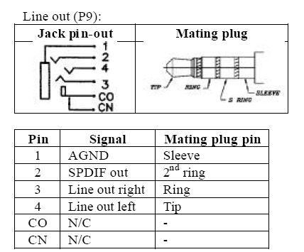

Ok, the wiring is detailed in the fit-PC2i manual :
audio pinout
audio pinout

In case some people want to make it :
jack search and specs for the 4 contacts jack.
