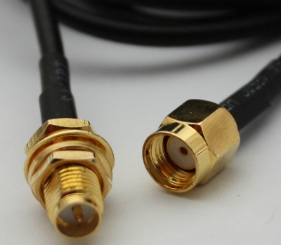

I'm curious as to the specifications of the connector for the WLAN antenna. We need to purchase extensions for our FIT-PC's, as they're too deep inside of a robot for wireless to reach.

The antenna connector is RP-SMA.
Here is an example photo of extension cable:

lol sorry for bumping old thread but Im wondering, if we get this cable, does it matter what length (e.g will we lose performance with lets say s 9meter cable) or does it not matter?

It will lose performance of course, but the equation is pretty complex.
You need to know the cable type, materials used, etc.
Here is an example: http://www.timesmicrowave.com/cgi-bin/calculate.pl
