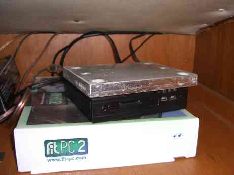

I have a piece of aluminium just slightly bigger than the fit-PC2 and about 1cm thick I found in my tool cabinet just lying on top of the computer and it reduces the temperature by about 10 degrees.

Can you place a picture of this alumimium bar? Is it from a CPU cooler or not related to computing?
Re: Heatsink from Compulab
It is just a block of aluminium I found on my boat. It is not even totally flat, i.e. it is not touching the computer with a perfect surface and I don't have any heat goo between.
Just ran a test now.
With a load (playing a Video using Windows Media Player) and the CPU running at 35-45%.
Without heatsink - 49 to 50 degrees celcius
With heatsink - 40 to 41 degrees celcius
Pretty good I think.

- fit heat sink.jpg (9.84 KiB) Viewed 20748 times

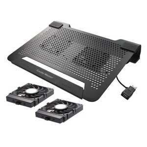

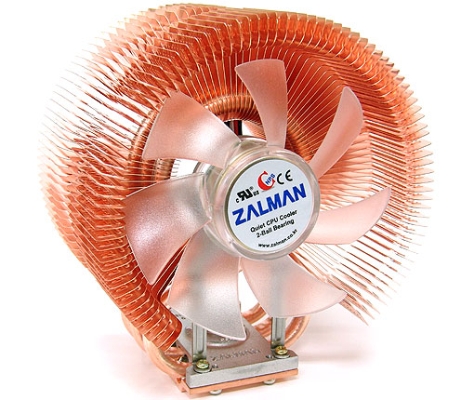

::: Dumb posting ALERT (Now with Pictures) :::
When not use a CPU Cooler w/ a Fan or "Laptop" cooler to cool the fit-pc2 ..
Your other PC will be jealous.
- Laptop cooler
- C283-3040_main_image001_im.jpg (43.96 KiB) Viewed 20707 times
- zalman
- ZALMAN_9500A_CPU_Cooler_.jpg (147.51 KiB) Viewed 20707 times
