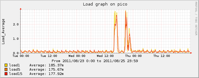

On the Load graph you can see when the system hangs.
- pico-Load.png (30.88 KiB) Viewed 22603 times
Re: home server on fit-pc | disappointed
There are multiple HW and SW issues that can cause the system to hang intermittently. The time scale of hangs makes overheating one of the least likely ones. You can easily test it by warming the fit-PC2 to 5-10C higher than normal (eg by lighting an incandescent light bulb at a proximity). If the problem is heat related then hanging rate should be an order of magnitude more frequent.
Without heat-sink and the same Load level system hangs in 30 min, so the problem is definitely the heat. If I'm installing an active cooler the system works fine. But I want a fan-less system.
I suggest you RMA the fit-PC2 for replacement - rma@fit-pc.com
