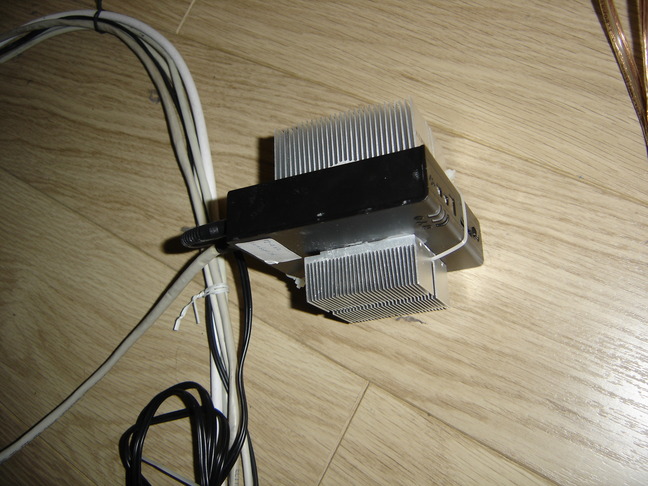

I also thought temps got a little high, so I simply attached two heatsinks without fan I had lying around. While it was probably fine with the higher temps, I prefer not to stress it more than necessary, especially the harddrive. It is tucked away in a corner anyway, so no-one sees it
I now get the following for a 7200 rpm notebook drive, with the fit-pc2 on its side and with heatsinks.
Thermal Sensor 0 is 50 C
Thermal Sensor 1 is 51 C
Harddrive temperature is /dev/sda: ST9320423AS: 37°C
edit: added picture.

Re: too hot?
thanks for the reply's, especially PieterPan for the screen-shot..
did u just use the glue you usually use to stick on processor heat-sinks?
i was considering attaching some myself but wondering what eh heat transfer will be like.
its currently sitting on a 2 fan usb notebook cooler (on top of 1 fan) if i attach heat-sinks,
I might disassemble the cooler and attach its fans under the heat-sinks (or over)

Actually is that glued or zippy tied (no both)

Re: too hot?
It is ziptied to the case, with crappy thermal stuff (not glue) in between, to improve the thermal transfer.
Re: too hot?
thanks for all the help.
i used your idea and incorporated a low powered fan into it for good measure,
the case is now not hot enough to be called warm as the heat sink looses heat faster then the system can dish it out.
