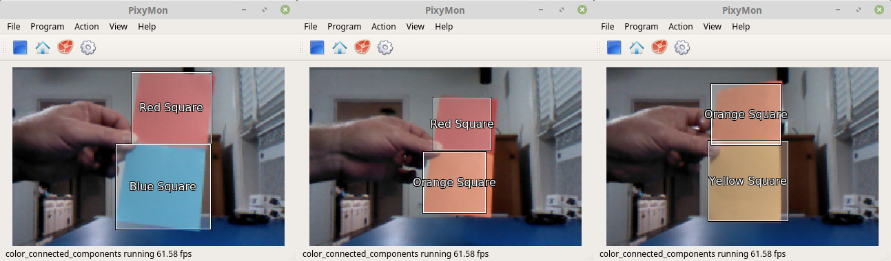

Pixy2 in conjunction with fitlet2 proved to be a fun and interesting system to explore. I was impressed with Pixy2's ability to accurately and consistently detect, identify, and track objects. The following images and videos provide more detail.
1. Object Detection, Recognition, and Tracking
Basic Shape/Color Recognition - Primary Colors
Basic Shape/Color Recognition - Blended Secondary Colors

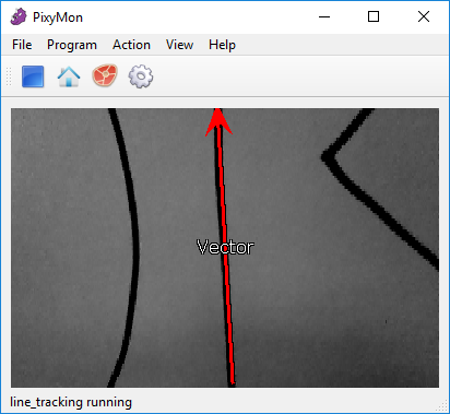

Since I am using Pixy2 in a more or less static configuration, I was not able to make a detailed exploration of its line tracking performance. However, the following picture shows that Pixy2 does its best to search its field of view for lines to follow.
Line Tracking.png (65.52 KiB) Viewed 16606 times
