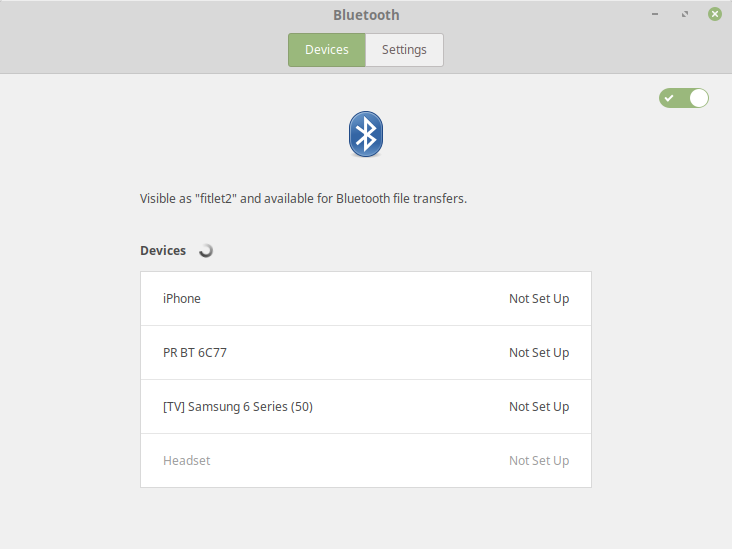

Step 2. Select Bluetooth for a List of Devices

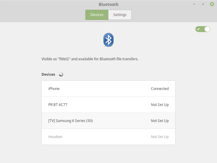

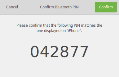

Step 3. Select the Target Device (iPhone) and Pair with fitlet2
Step 4. Confirm Pairing was Successful
