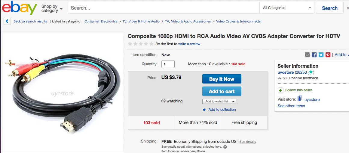

This is an old post so your link is dead. I'm looking to connect my FitPC2 to a monitor with only composite input. I don't need audio, only video.
There are HDMI to composite adapters such as these,
http://www.ebay.com/itm/Composite-1080p ... SwCQNWfgPS
but they only transmit the signal, they don't do any conversion. In case my link doesn't work, I've attached a photograph.
The question is, would something like this work on the Fit-PC2 or would I also need a signal converter? I guess the bottom line is whether or not embedded in the HDMI connector of the Fit is also composite video.

halestorm wrote:This is an old post so your link is dead. I'm looking to connect my FitPC2 to a monitor with only composite input. I don't need audio, only video.
Ah yes, the link is no longer valid. See below for a similar type of device as was originally posted:
http://www.gefen.com/kvm/gtv-hdmi-2-com ... d_id=11402
The link you provided, as you noted, only transmits the signal to composite cables. The only way that actually works is if the signal being transmitted is actually a composite signal. With an HDMI output device, that's almost never the case, and I can confirm is not the case with the fit-pc series of devices. They only output digital signals over HDMI.
What you need is called an HDMI scaler or signal processor. It reads in the image, converts it, and then outputs it over composite. That said, my experience has been to be sure to carefully read the supported configurations of the scaler. For us, we had to jump through several hoops to output the "right"/acceptable resolutions, frequency, and color bit depth in order for the video to be interpreted correctly. Anything slightly off would have no video or turn grayscale. I remember having to install the IEGD tools and make a custom driver that forced all those expected settings in order to make it work, albeit it could have been due to the particular scaler we purchased having limited resolution/frequency/color depth support. We were using the convert to broadcast from a fit-pc to a CATV system using dedicated hardware, which by itself is kinda strict with requirements already.
The one in the link I provided appears to support a fairly wide arrangement of resolutions and frequencies, but note that I have not tested it myself and cannot personally vouch for it. I'm just describing the type of device you need.
