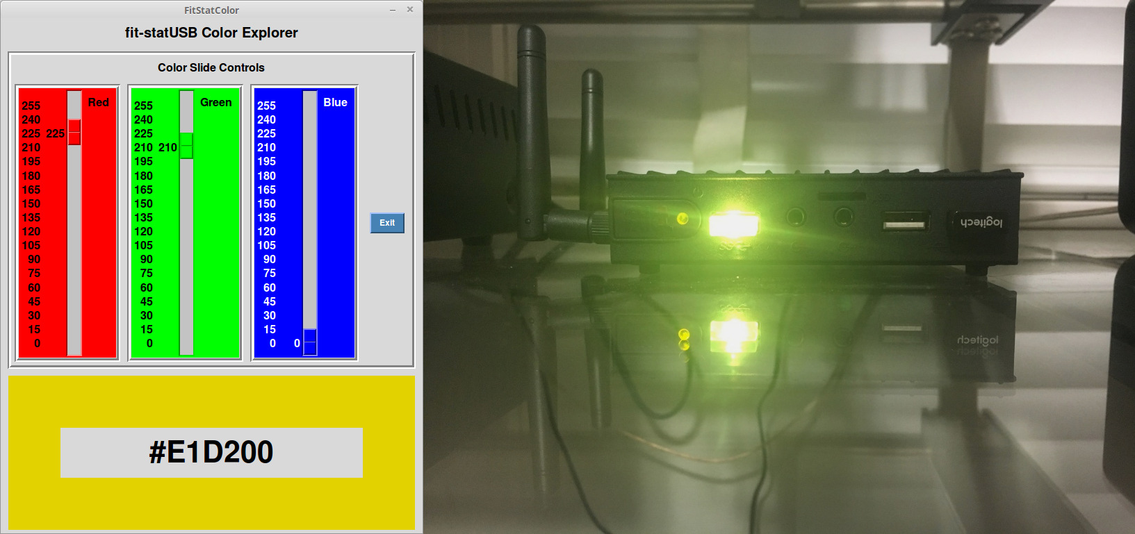

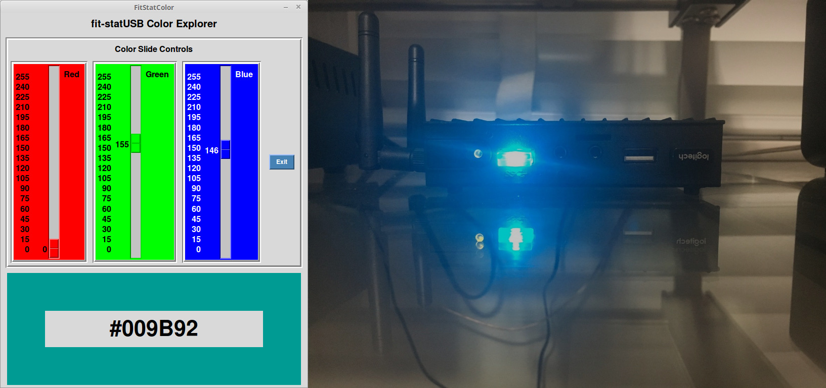

How many distinct colors can fit-statUSB display? The answer to that question is 256 Red x 256 Green x 256 Blue which equals 16,777,216. Realistically, the average human eye can't discern that many colors, but a bit of fun can be had by trying.
The perl app included in this post provides the user with a simple method of quickly exploring the various colors which fit-statUSB can display via 3 slide controls (red, green, and blue). The resulting color combination is displayed both on-screen and by fit-statUSB. The app prominently displays the corresponding hex code. Should the user arrive at a desirable color, the hex code can be written down for further use in applications.
Examples
Shade of Purple
Shade of Yellow
Shade of Blue-Green
Perl App
