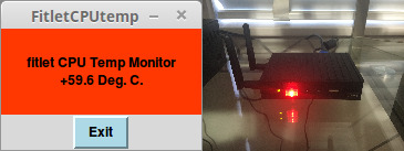

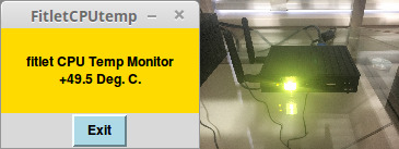

Sample Output of Perl App Showing App Window and fit-statUSB Output
Cold CPU
Warm CPU
Hot CPU
