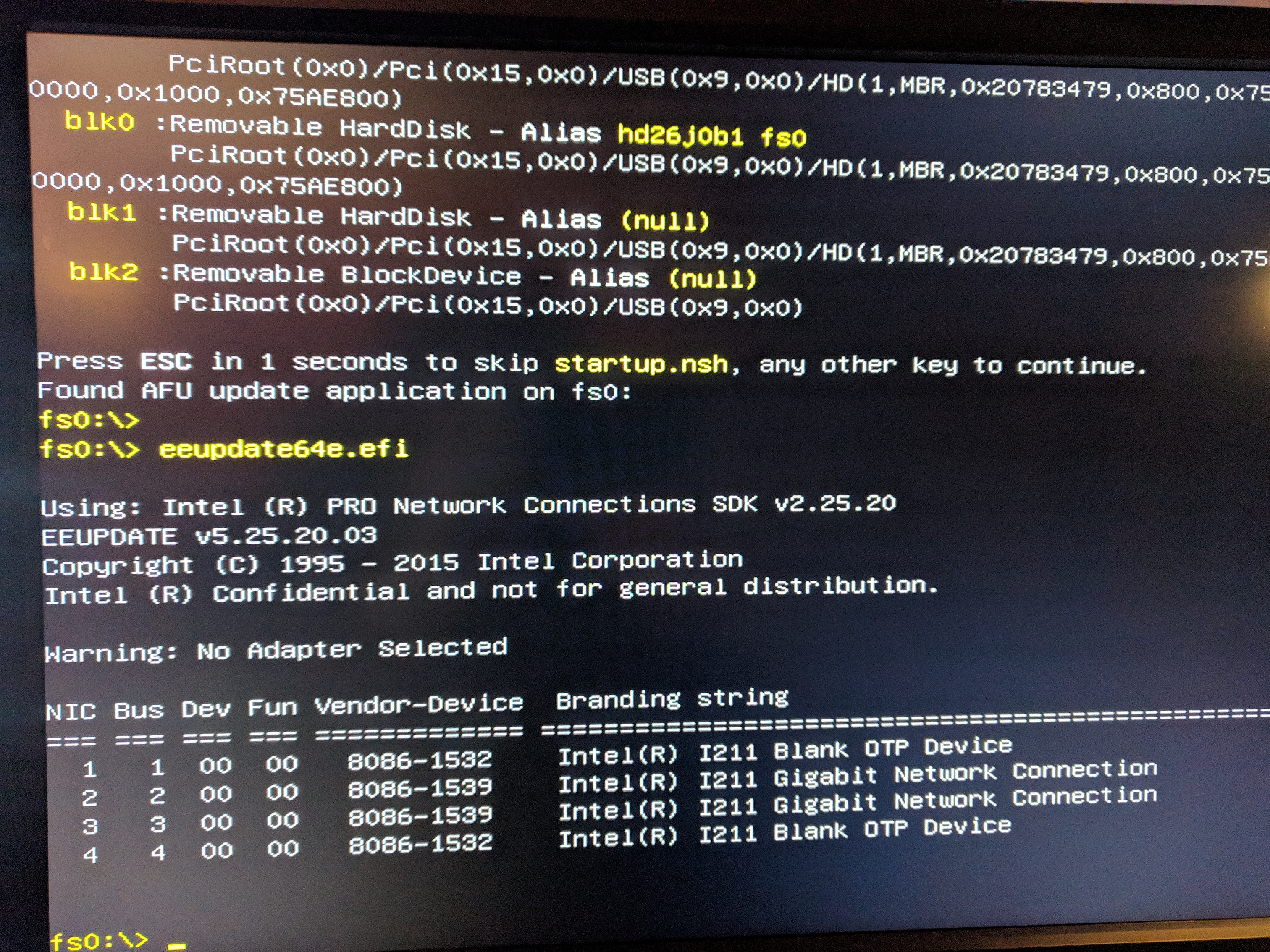

Here's the output. Thanks, Leonid.Leonid wrote:We need the screenshot with the output of the eeupdate64e application as described above.
edit: got the PM, thanks.
- 20180103_234557_resized.jpg (263.83 KiB) Viewed 26230 times

Re: fitlet2 does not recognize LAN FACET Card
Hello,red wrote:Here's the output. Thanks, Leonid.Leonid wrote:We need the screenshot with the output of the eeupdate64e application as described above.
I sent the private message with instructions how to program the blank LAN controllers.
Leonid Firdman

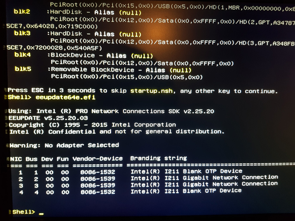

Hello,
unfortunately we have the same problem with our newly purchased fitlet2:
Using: Intel (R) PRO Network Connections SDK v2.25.20
EEUPDATE v5.25.20.03
Copyright (C) 1995 - 2015 Intel Corporation
Intel (R) Confidential and not for general distribution.
Warning: No Adapter Selected
NIC Bus Dev Fun Vendor-Device Branding string
1 1 00 00 8086-1532 Intel(R) I211 Blank OTP Device
2 2 00 00 8086-1539 Intel(R) I211 Gigabit Network Connection
3 3 00 00 8086-1539 Intel(R) I211 Gigabit Network Connection
4 4 00 00 8086-1532 Intel(R) I211 Blank OTP Device
Can you please send me the instructions how to flash the EEPROM?
Thank you!

Re: [SOLVED] fitlet2 does not recognize LAN FACET Card
Hello,consistec wrote:Hello,
Thank you!
Leonid Firdman
