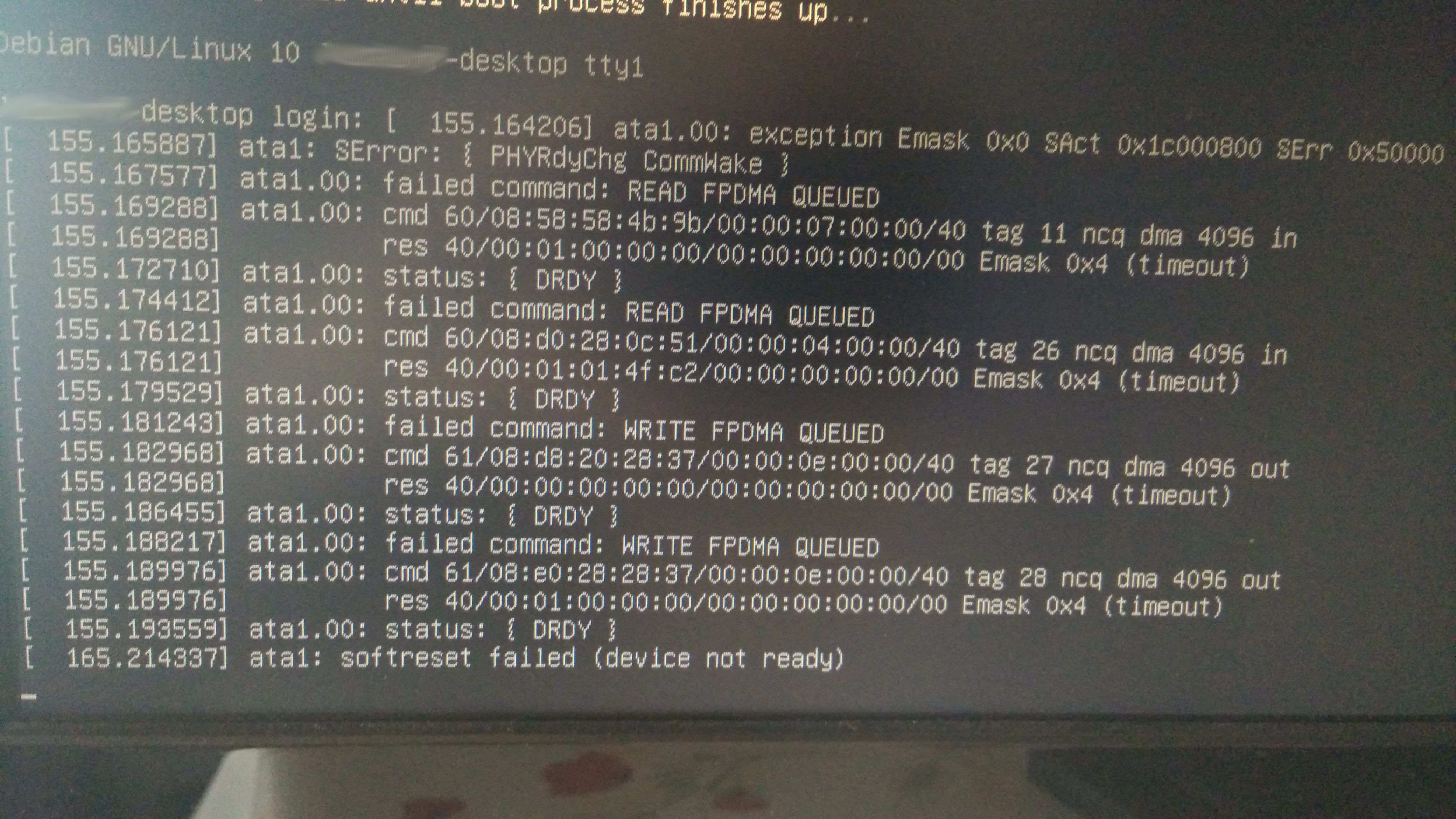

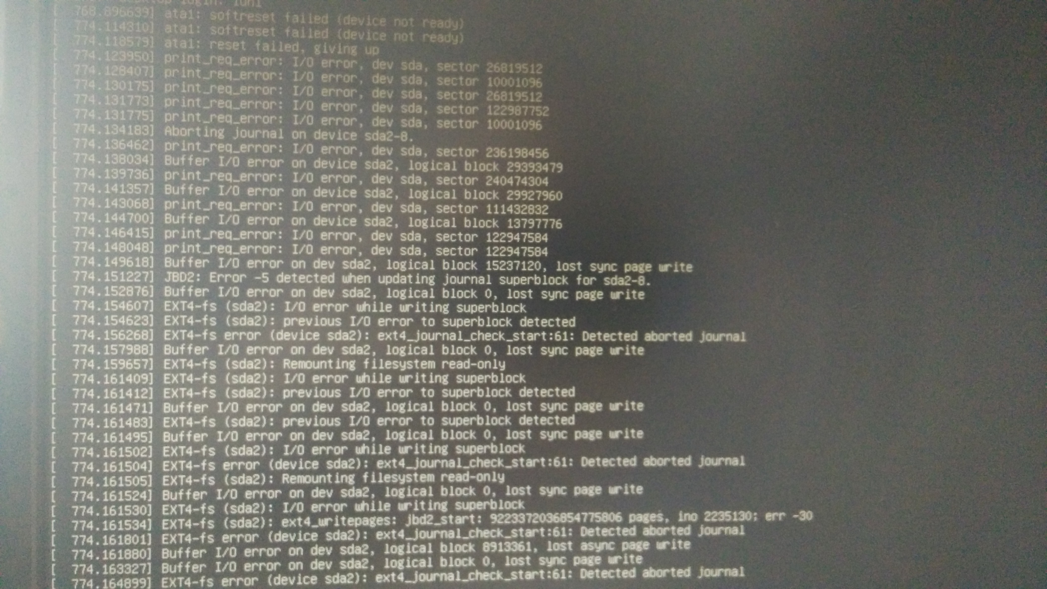

I have a Mintbox Mini Pro 2 which I really love.
But since the beginning, I found the SSD a little bit slow, but it was ok for me.
I use Rambox and parameters are often lost. Maybe not saved correctly ?
SSD device is NT-128.
I updated from Debian 9 to Debian 10. But now I have strange behaviour.
Randomly system puts himself to read only mode. I am forced to hard reboot.
Yesterday, NT-128 completely disappears from BIOS, and from gparted live.
Today NT-128 is back.
I tried to investigate.
gsmartcontrol from gparted live says : short test + long test : all is OK.
gsmartcontrol from debian says : sometimes all is OK and sometimes gsmartcontrol crash and can't continue.
But I found that, when I do : smartctl -t long /dev/sda
System always crash and becomes read only after some seconds.
I attached screenshots after crash.
I try to add these grub parameters : irqpool all_generic_ide noacpi
System still crash after smartctl.
Can you help me ?
Problem with SSD ?
Thank you.
