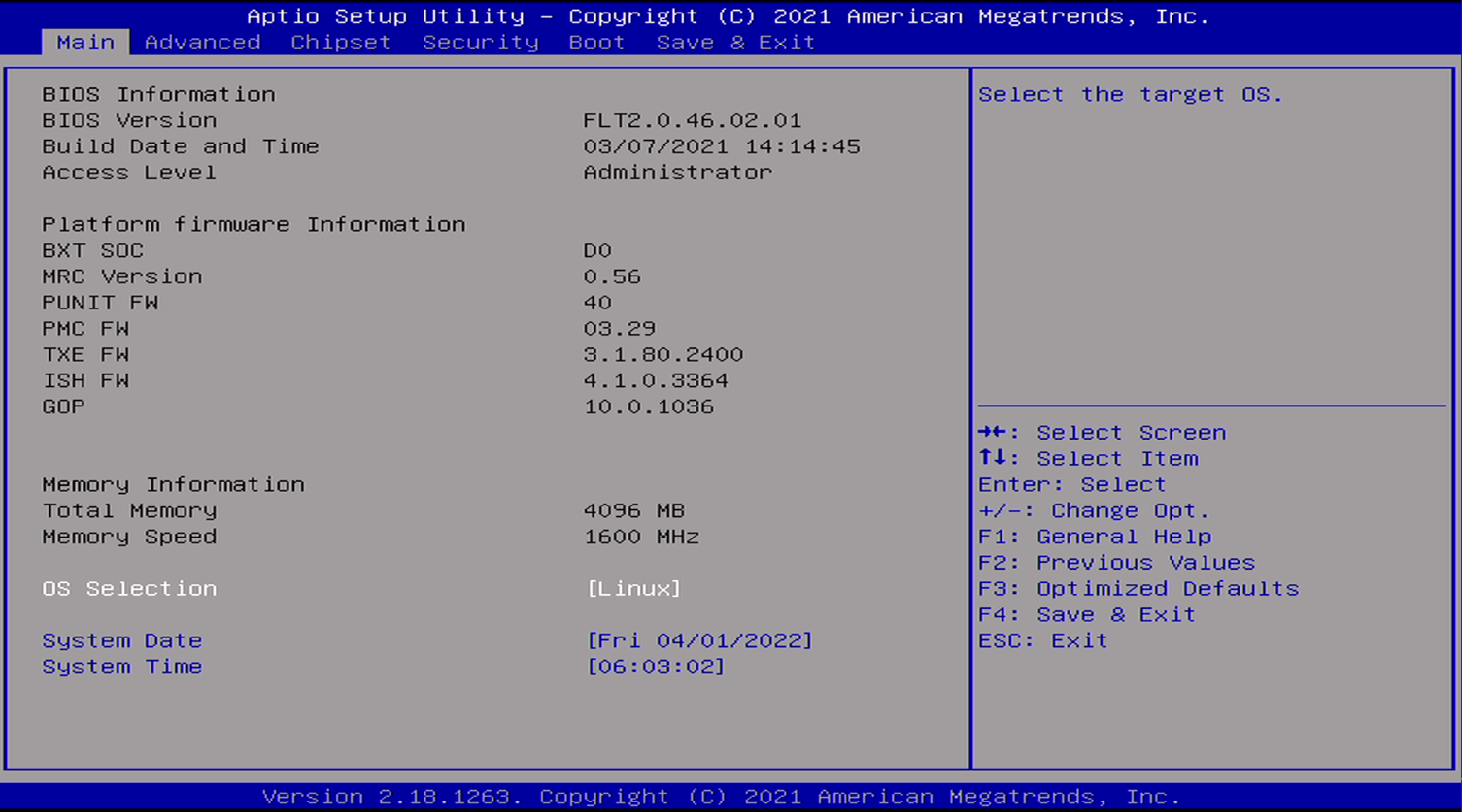

Hi.
I'm seeing the same issue with the leds are on by default, even after bios upgrade. Bios is currently FLT2.0.46.02.01. Am i missing something?
