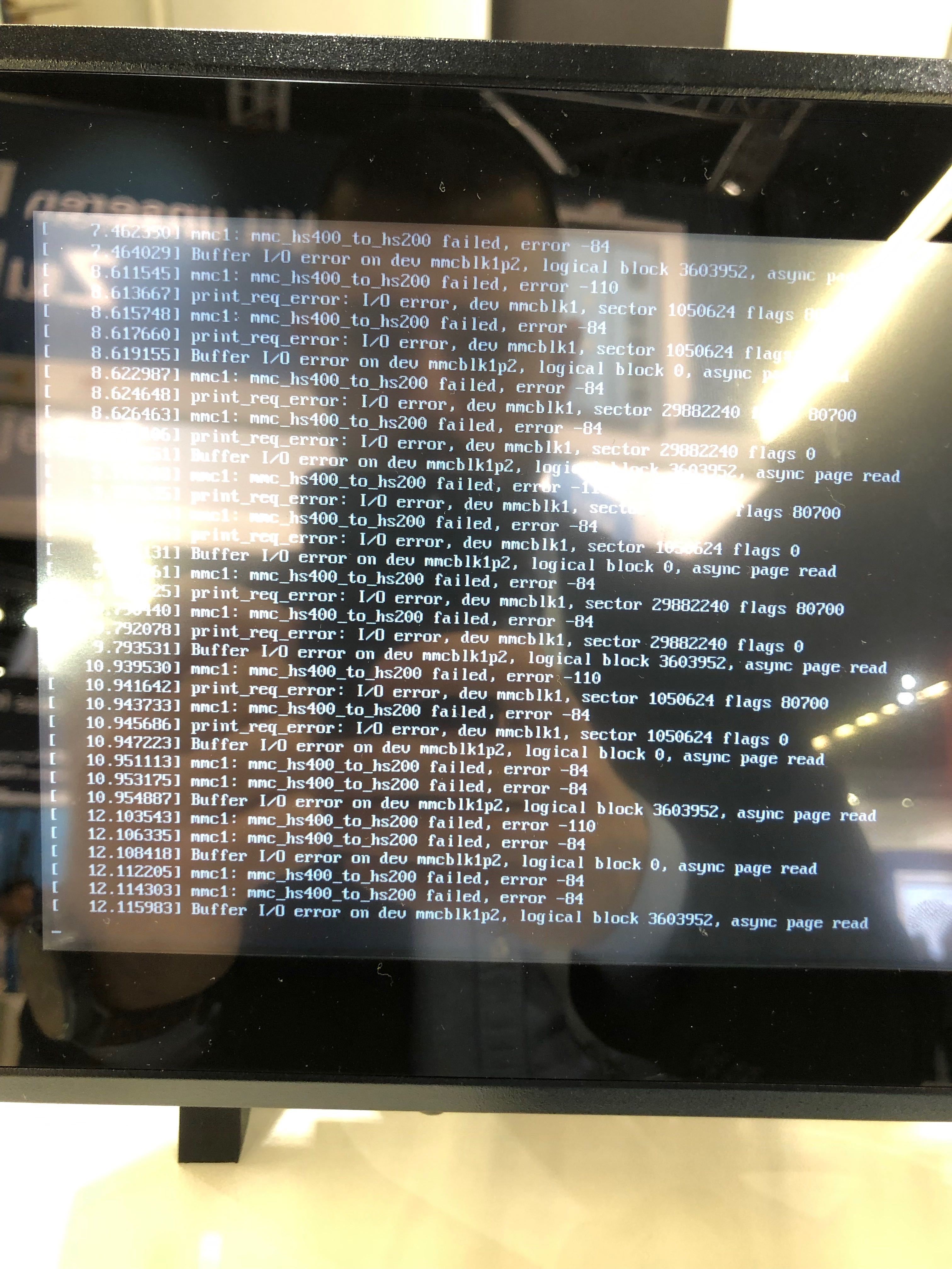

I have a Fitlet2, that has some weird cold boot behavior (by cold boot, I mean that it wasn't on for 4+ hours)
I've tried installing Ubuntu 18.04, Ubuntu 19.04 and on both same behavior occurs:
- First time you boot, the screen stays on the flat purple color (#5E2750), nothing shows up on it, F12 doesn't switch the view to the one where you see services raising up, it is completely frozen
- Second (and third, fourth, fifth.... ) the system will boot and dump error (see attached image) and end up in initramfs.
- The system will boot after a couple of restarts, anywhere from 5 to 10 boots and it will succeed in booting. After that, the PC can be restarted, shutdown and booted up, and the PC will function just fine.

Our R&D diagnosed possible issue with the storage device itself.
We haven't got the S/N or P/N of the machine but we guess it is an eMMC storage device installed according to the logs.
We suggest to initiate an RMA procedure to have this part replaced:
https://www.fit-pc.com/web/support/rma/
