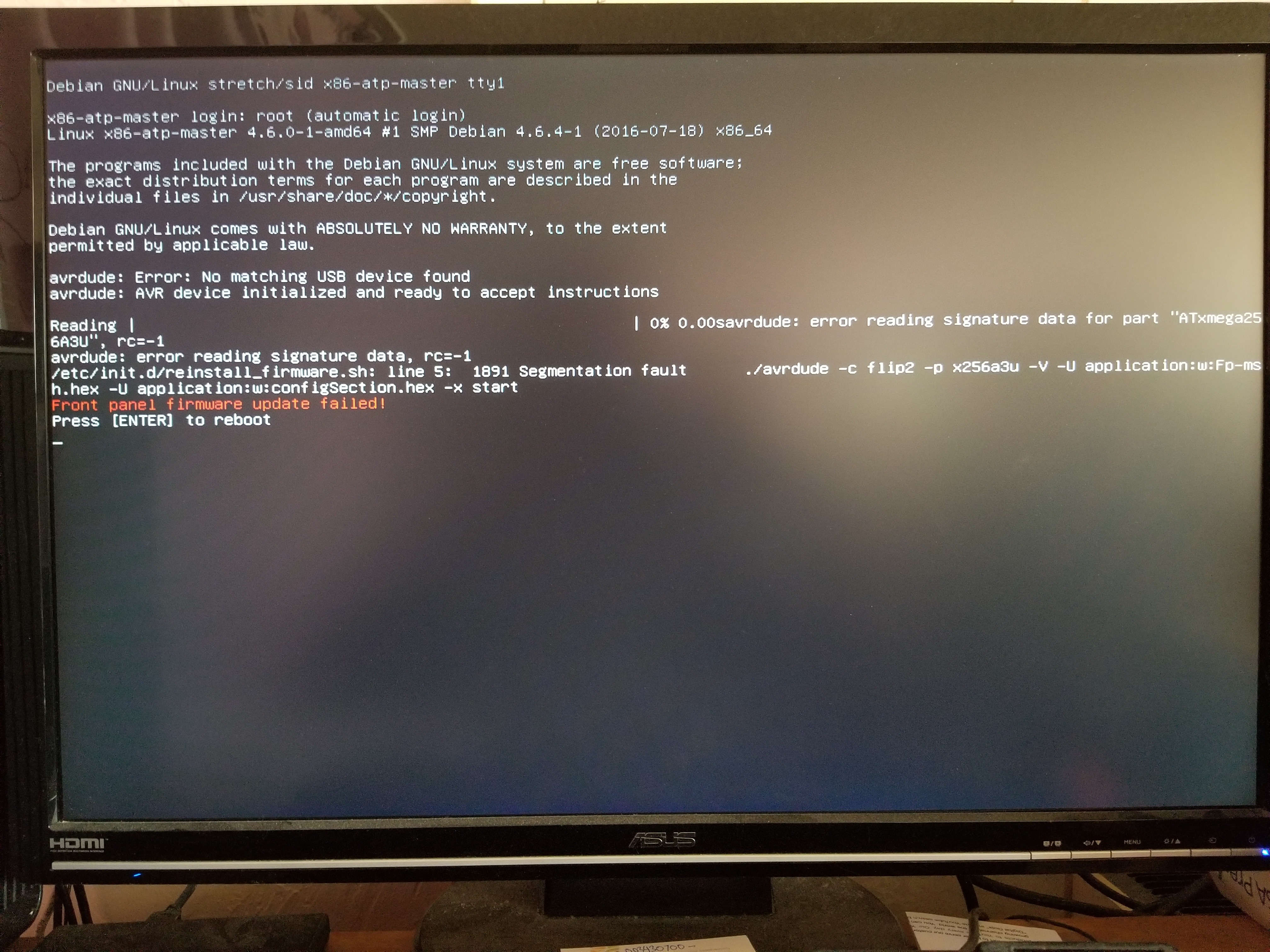

Assuming some API compatibility issue, I checked for a new version of the Linux I3M .deb package. There has been no update of airtop-fpsvc_1.0-1_systemd.deb for quite some time so I decided to try to update my BIOS/ME and I3M firmware. The BIOS update went okay (after I restored grub-efi to working order). The ME seemed to go okay as well. The I3M update did not go so well. According to the Wiki, one must press the left and right I3M buttons while applying power (after power has been unplugged for a while). When I do this, all I get is a blank I3M display. I never see any indication of anything being placed into "bootloader" mode. I tried doing the update while the display is blank and get the error shown in the attached photo. (I also tried the update while doing different iterations of I3M torture, but always got the same result.)
What is the secret incantation to make the I3M firmware update?

Hi Jeff,
Regarding placing the front panel in bootloader mode, you need to hold the buttons until the words "bootloader <version>" appear on the front panel. It typically means holding them for a few seconds.
However, you don't need to update the front panel firmware. The GPU and CPU temperatures are not displayed because the Linux Front Panel daemon is not working.
Try reinstalling the daemon (see this link).
If after installation you still don't see the temperatures changing, post the output of cat /var/log/syslog | grep airtop-fpsvc.
