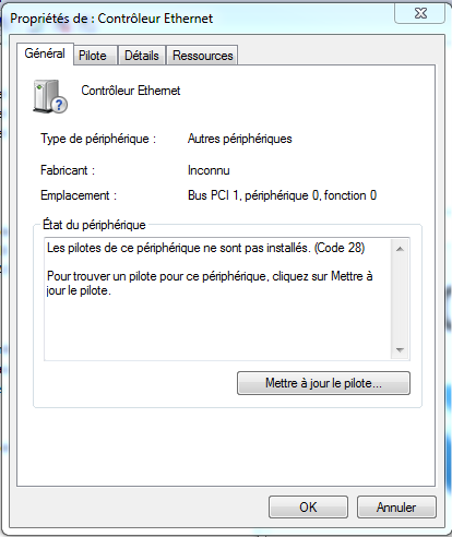

I still have problem with those driver for the facet card.
for the mainboard : no problem.
for the facet card:
1- after installation intel dirver -> the driver are not installed. Code 28
2- I choose the drivers manually -> the periph can't start. Code 10.
Do you have a solution ? or is there a problem with this card ?
OPP
2017-01-09_ driver erreur 10 -3.PNG (70.68 KiB) Viewed 15667 times
2017-01-09_ driver erreur 28 -2.PNG (30.18 KiB) Viewed 15667 times
2017-01-09_ periph -1.PNG (66.54 KiB) Viewed 15667 times

For the facet card, I have the PID 1532.
When I'm looking on intel documentation, this PID is indicationg an un-programmed device.
On the mainboard, the PID is 1539, which is programmed.
or is it RMA ?
OPP
