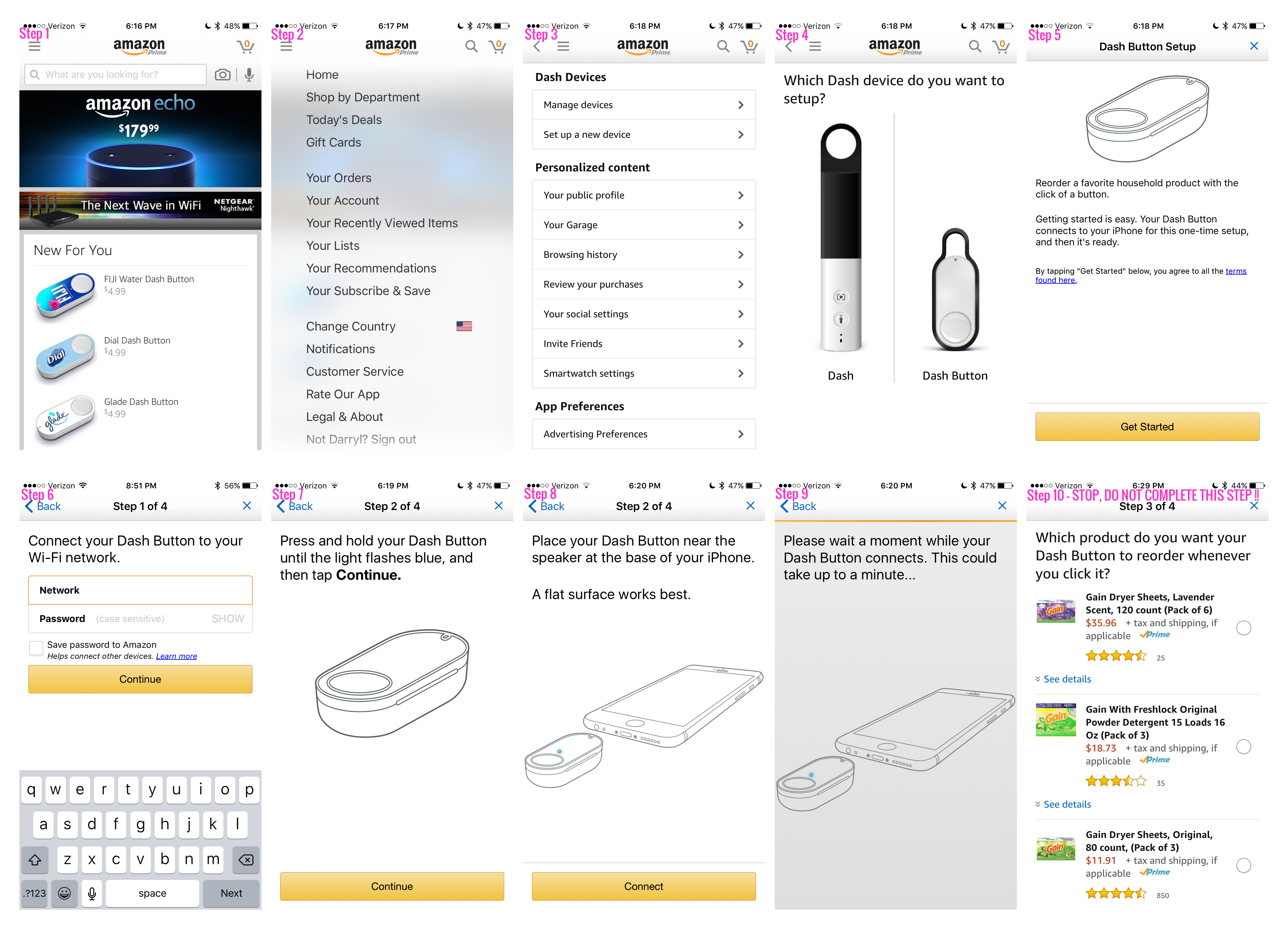

Configuring a Dash Button
Using an iOS Smart Phone
1. Open Amazon app
2. Open selection screen and select "Your Account"
3. Scroll to "Dash Devices" and select "Set up a new device"
4. Select Dash Button
5. Select "Get Started
6. Input network name and password
7. Press and hold Dash Button until blue LED flashes
8. Place iPhone next to Dash Button and press "Connect"
9. Wait for audio data transfer to complete
10. STOP - DO NOT SELECT A PRODUCT, OR EACH TIME YOU PRESS THE BUTTON YOU WILL PLACE AN ORDER !!
11. Exit the Amazon app - Dash Button configuration is complete
View Image To See iPhone Screens For Steps

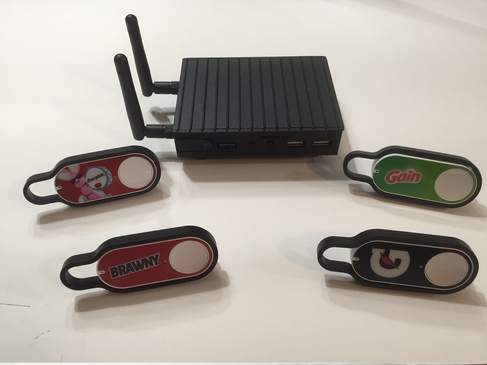

Experiment with Amazon's Dash Buttons Using Fitlet
