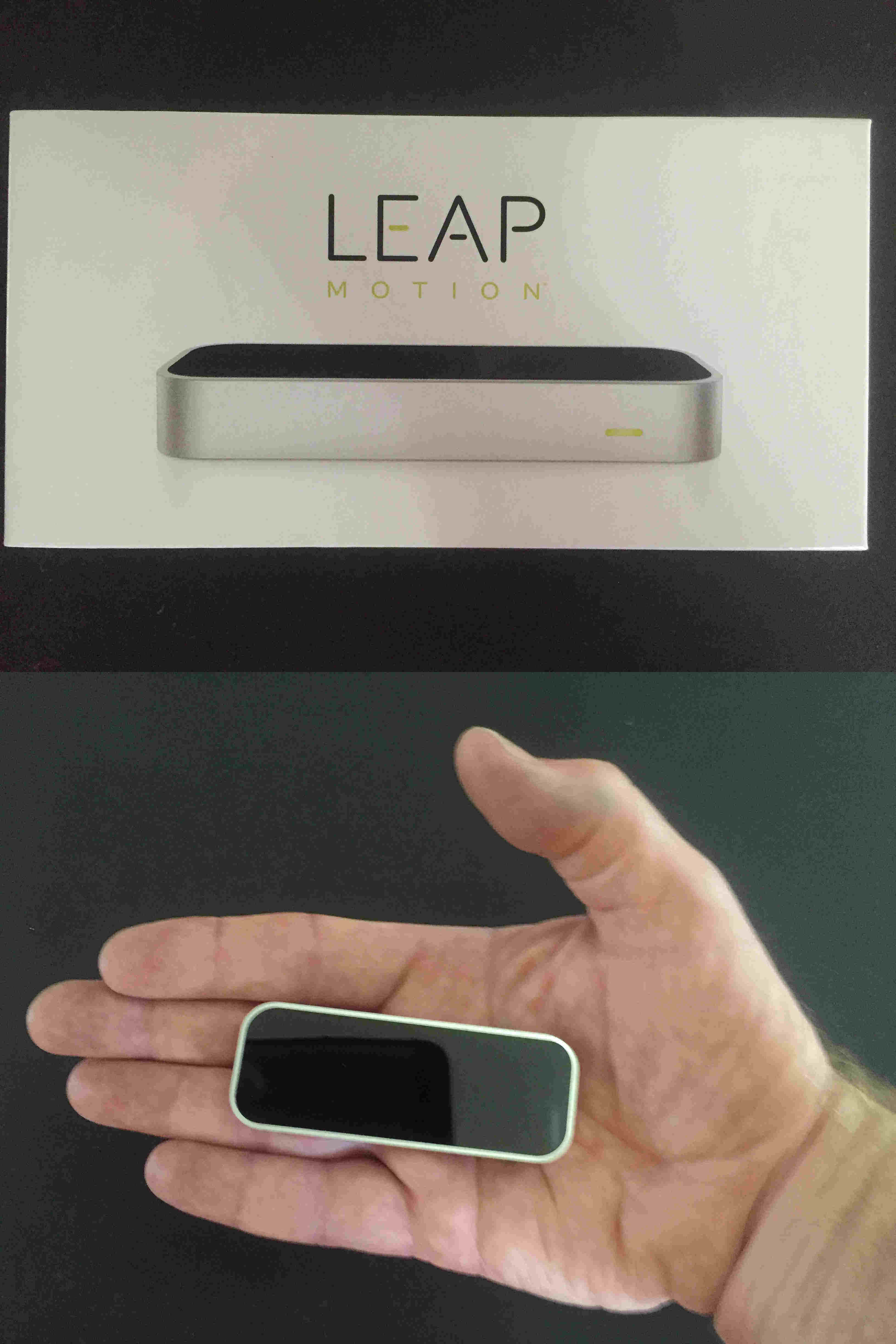

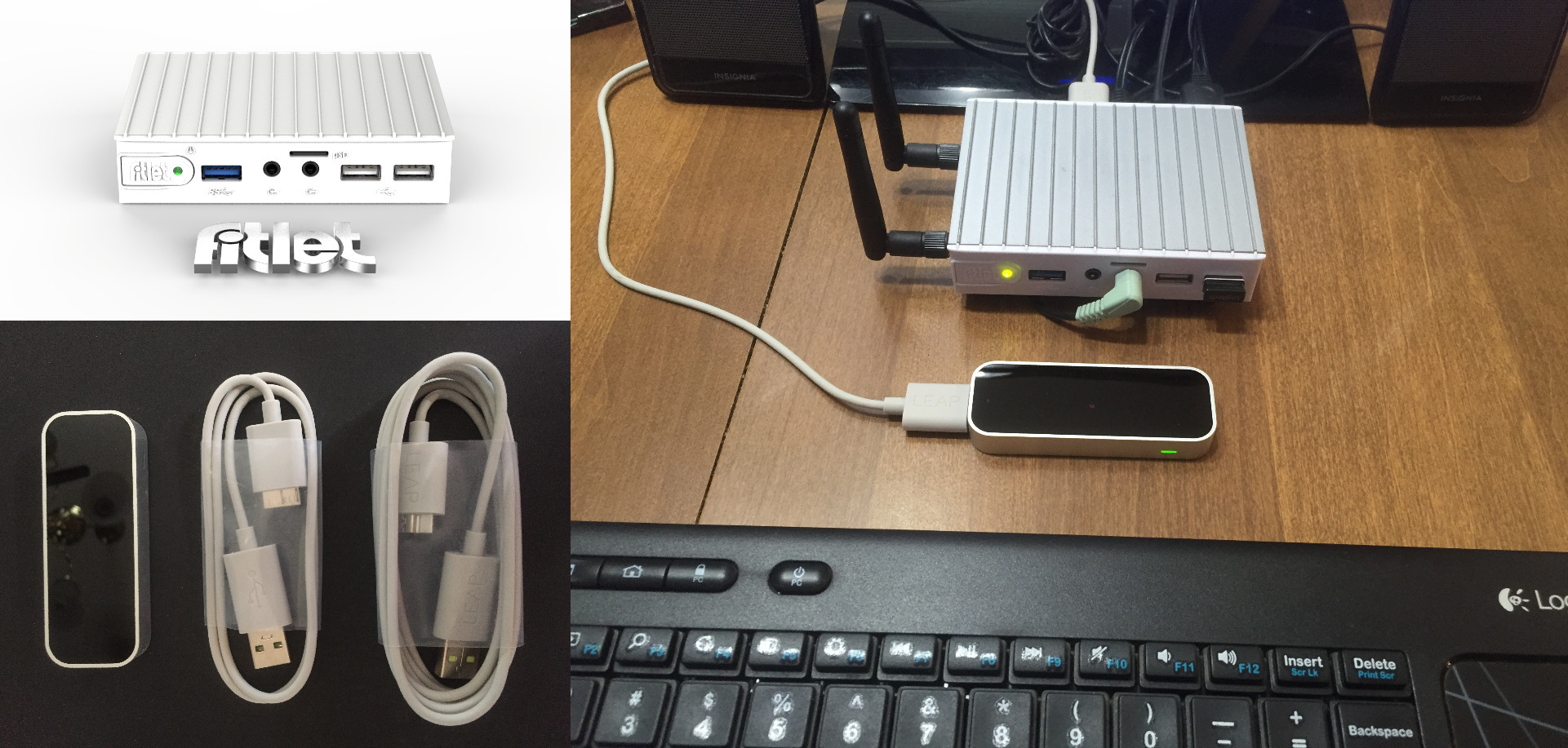

The hardware required is:
1. Fitlet
2. Leap Motion Controller
3. Special Leap Motion USB Cable (Included with controller)

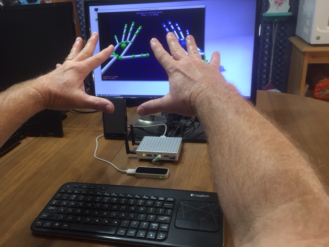

1. Connect the Leap Motion Controller to fitlet.
2. Verify the Leap dameon is running using the command sudo service leapd status
3. Run the software using the command LeapControlPanel. An oblong, green tray icon should appear.
4. Right click on the tray icon and select Diagnostic Visualizer. A window containing a 3D grid should appear.
5. Place your hands above the Leap Motion Controller and begin experimenting with gesture control.

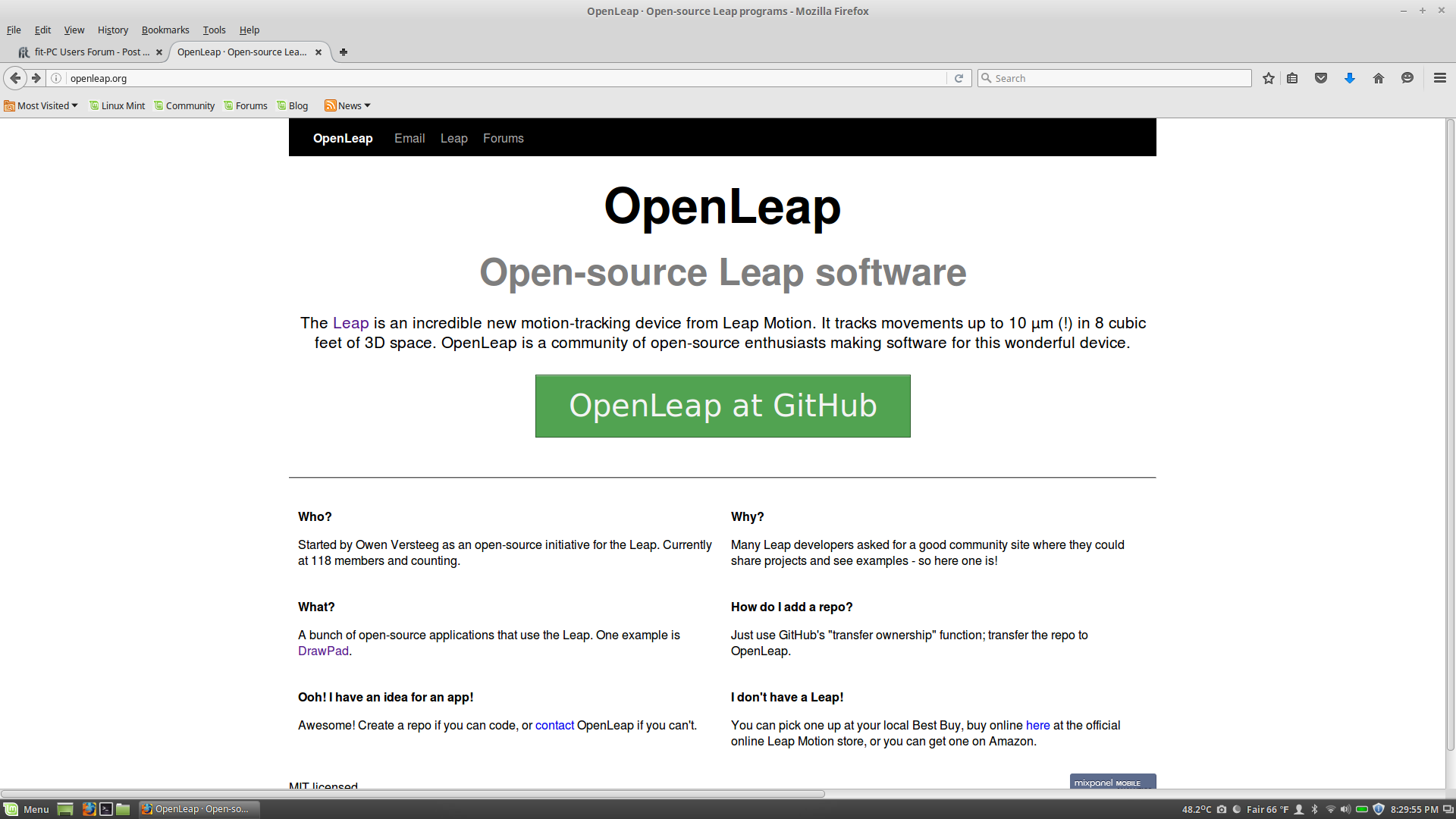

Open-Source Leap Motion Apps
Admittedly, the selection of Open-Source Leap Motion Apps suitable for use on Fitlet in Linux is somewhat limited, and most of what is available is targeted towards Windows and OS X. That being said, there is a library of Linux apps and that library is growing over time. One source for Linux ready Leap apps is:
Open Leap found at http://openleap.org/ With a bit of searching, other sources can be found.

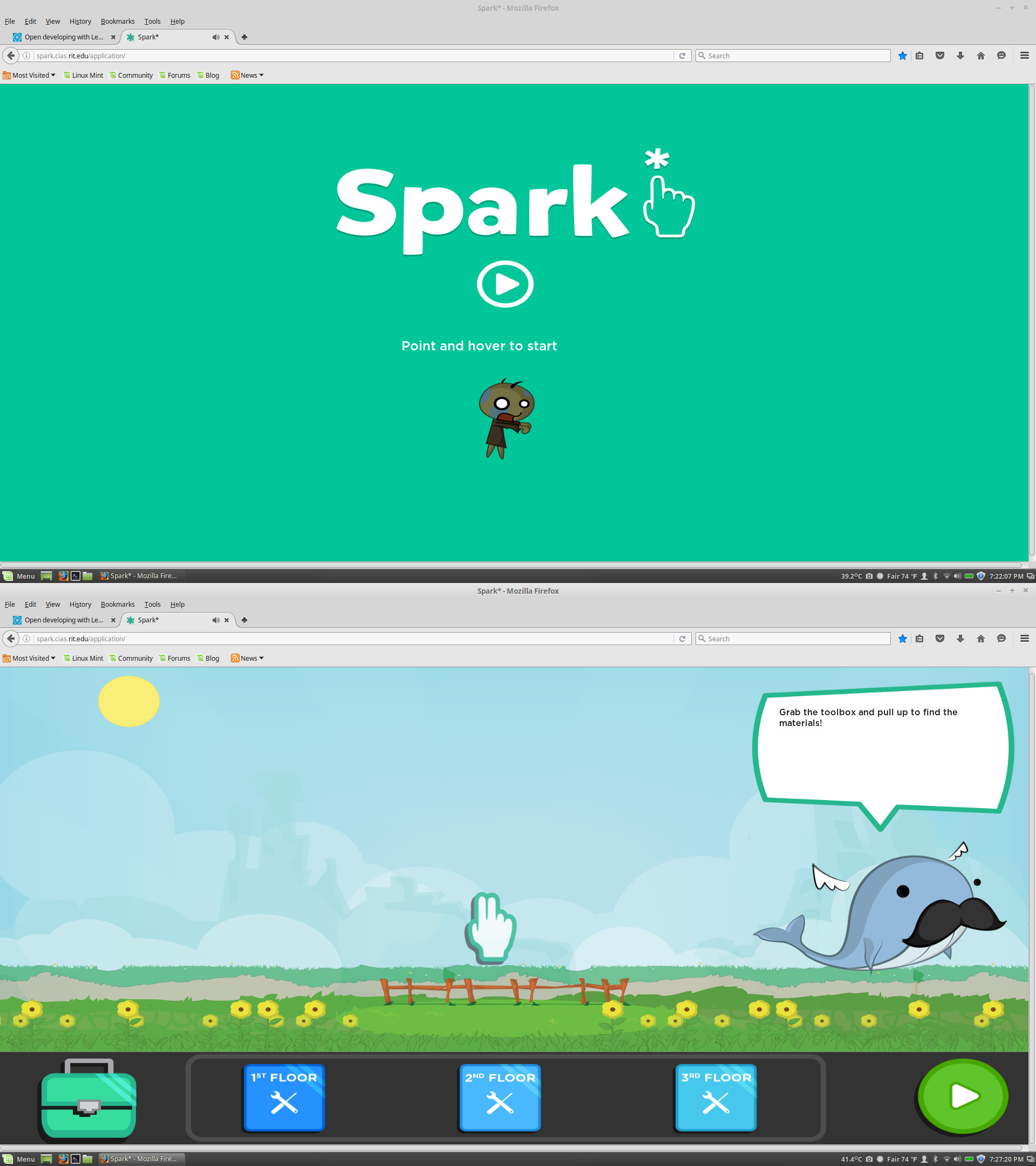

On-Line Leap Motion Apps
Some quite interesting On-Line Leap Motion Apps are available. These apps do not require installation and are a quick, easy, and fun way to explore the capabilities of Leap Motion.
Fend off Zombies in the on-line app called Spark found at http://spark.cias.rit.edu/application/

The results while running the Diagnostic Visualizer on fitlet were encouraging. The software tracked my fingers, hands, and arms relatively well. Most movements and gestures were tracked, but occasionally things got a little bit confused and the depicted hand positions didn't match reality.
Overall, watching your hand movements being mimicked on your computer screen is a bit mesmerizing.
