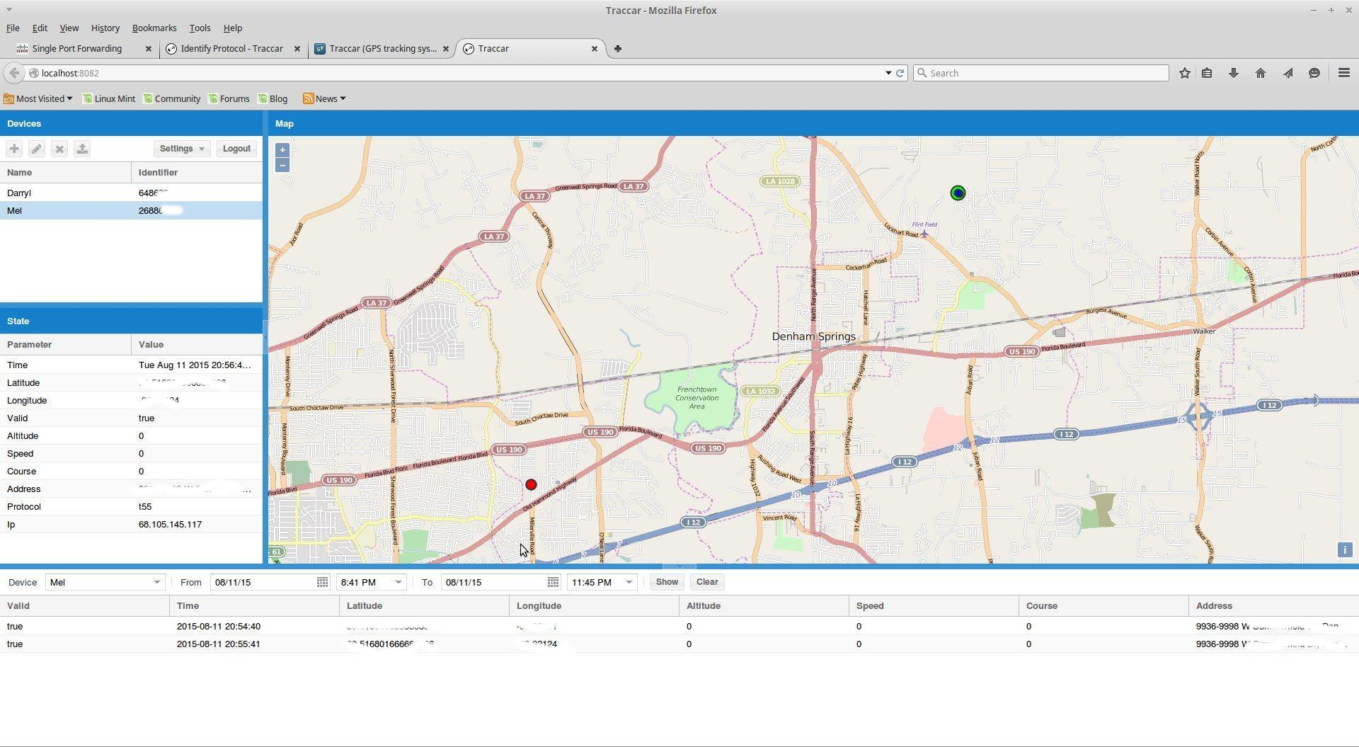

Access to a map based graphical interface is via a web-browser connected to local port localhost:8082. Tracked assets are depicted as red/green dots on the map. Log data is available through the interface. Tracked Devices can also be added via the interface.
2 Stationary Assets Tracked
1 Moving Asset Tracked
